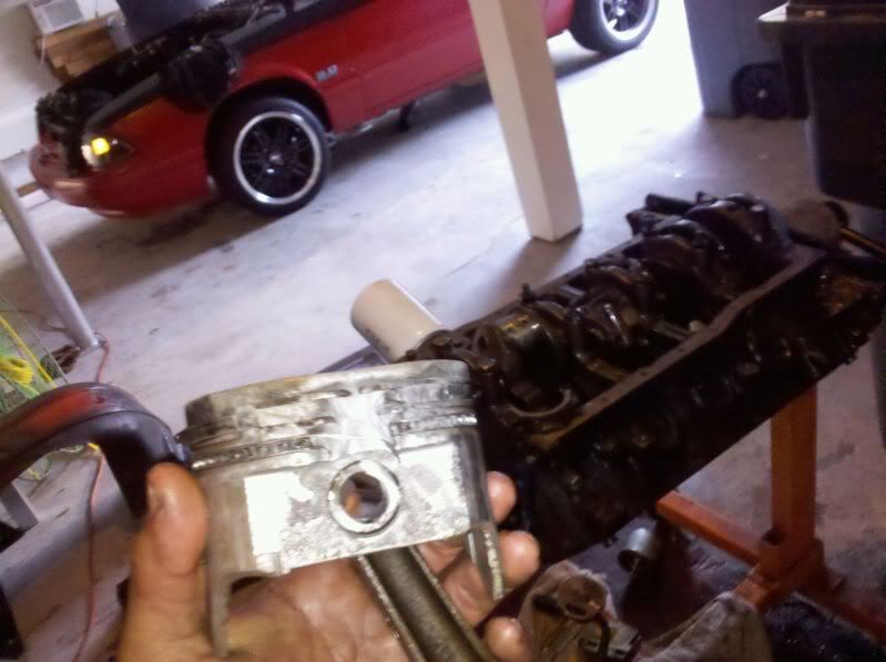

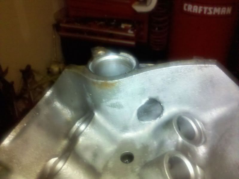

Is this a hole in my 302 block pics inside

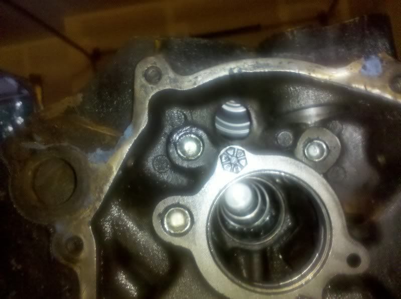

Front of motor
Valley
Piston
Sent from my Droid using Tapatalk

Yeah I'd say that's hole. Dosent look good.

That's completely normal.
It's one of the oil drain back holes in the block. It's rough cast and not machined, I've seen a bunch that looked like that.
The piston on the other hand.....

Thank god! Yeah detonation is a #itch!

I take a die grinder and a bur bit and clean the bottom of the drain hole, radius it flush at the bottom

Neither of the 3 engines I had, EVER had one of those, looks like a hole to me!

I wanna say that is normal, but i haven't had a 302 apart in awhile.

Nope, completely normal. Some blocks are worse than others.
If it's a hole, I'd like to know how it got there. I've never seen a hole knocked in something cast that had smooth edges where it broke.
x2, it should look like this when it's done.

100% normal

Block looks norm.. Can't say tat for the piston...
