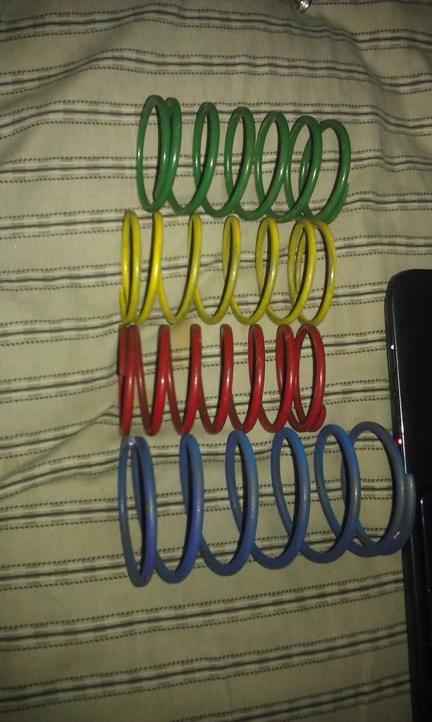

Instructions say yellow adds 2 lbs, red 3 lbs, and blue 5 lbs. Personal experience what have people actually been hitting with the diff springs? Combo
stock shortblock
ported tf170s
stock cam 1.7s
lookin for 8-10 or so, would rather hit less than more

what seems odd is the yellow spring is the easiest to press of the 4, so from my understanding that would be the least boost, not the green

Out of curiosity, did any other on3 users have the big blue spring in their wastegates? These are my old springs. I was told it was a 9lb spring in the wastegate.

Barret (sp) Jackson the blue spring. It's worth more than $600 <3

use the yellow its the inner and the blue for the outer will get to about 8 to 10 mine hade the same style springs

on3 insructions say the blue is stock (9)+4?

wait I see what you mean, big spring is base, then inner springs add boost?

nevermind, instructions say blue adds 5, so Im confused

you can tell the sizes of the springs by looking at the thickness of the coils. thicker coil means more boost. best thing to do would be to install the smallest spring, tune, and move up from there

lookin like what the plan is since I read 9 diff things about them, ohhhhhhhh well

well depending on the setup one car might make 10lbs on one spring and your car might make 8lbs on the same spring. One car could make 400whp on 8lbs and you end up making 450, etc...

With big blue spring I pulled 10 psi.
