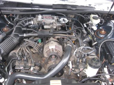

If I were to go modular, unless I was using the Trick Flow heads and wanting to make a car that has that motor stock, surprise people I would not bother using a 2valve. It just isn't worth all the work. They don't breath enough to make lots of power, take just as long to fab up to get in, and don't look as nice.
I would go with a 4 valve just for the "open hood ohhs and ahhhs." It just looks a brawny motor.
What looks better
or
But that is just the opinion of one guy. But know I didn't even use the Terminator engine, which is 1000 times more aesthetically pleasing.
Either way, the 4.6 isn't a bad engine I just wouldn't swap a 2v when all the same work, and similar money to get a 4v that runs and breaths like a OHC should.
