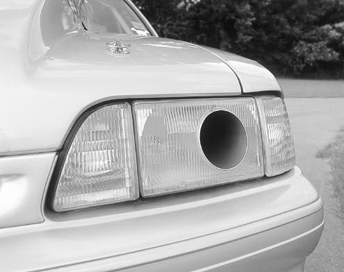

also intrested in where the bend off the turbo leads to. i was thinking of making my own ram air intake for it and trying to gather ideas. one was to trim the metal behind the head light so i can fit a 4-5 inch pipe threw and take my old headlight and cut a round hole right threw the center. so when i wana take it to the track i can pull the good headlight and stab in the one with the hole in it and the pipe will clamp to the turbo. so it has the Out Law style look to it but still be removeable for the ride home.

like this but maybe an inch bigger and on the passenger side and would feed right into the turbo.

If you are making a lot of power on a 4 inch inlet turbo they HATE anything restricting air flow. Have you tested that elbow in front of the turbo on the dyno vs. it being open? I tested two different types of filters and a screen and all cost a lot of power upwards of 8 psi and 600 rwhp.
The hole in the headlight thing will fail true street tech if you guys run in that. You need working lights.
