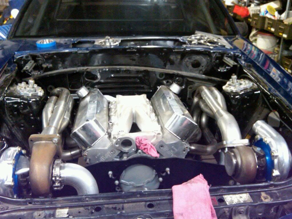

Hello all I am a fabricator that is building a 92 Fox for a friend of mine and he purchased two 76mm On3 turbos from ebay. Let me explain the combo before asking the question, 347 cu in. twisted wedge raised port heads. Dart block. CSU Blow thru carb. Jesel shaft rockers. Turbo 400. PT1000 liquid to air intercooler. 2 HKS 50 mm wastegates. custom headers. ams 1000 boost controller. This car is being built to handle big power so this brings me to my question... Has anyone maxed these turbos out? how much boost will they make? has anyone ever run twins? anyone run a liquid to air before? any info would be very helpful. thanks[IMG][/IMG]

we originally ordered these turbos strickly for mockup due to the fact that turbo tecnology is moving along so quickly with billet wheels and ceramic ball bearings that if we ordered the precision 76mm turbos now by the time the car was done they would be sooooo last month. I honestly think that these may be a better street turbo. obviously they will not maximize this combo but if they make 15 psi this thing could make 800hp (with $300.00 turbos) pretty cool right?

i have seen one on3 76mm kit on a 331 put 780 on the dyno 18lbs of boost

They'll do that no problem. Its how long they'd last at high boost levels is what id like to see. They're not the most efficient, but they'll do 800hp on that setup.
