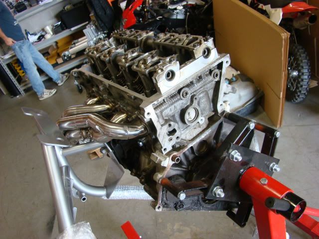

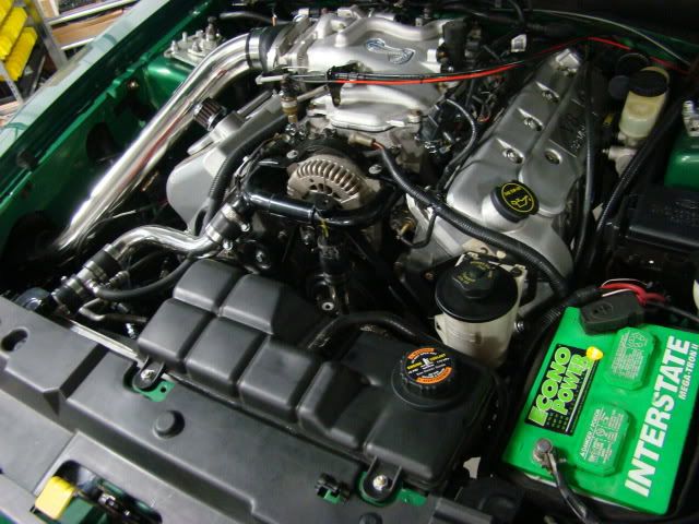

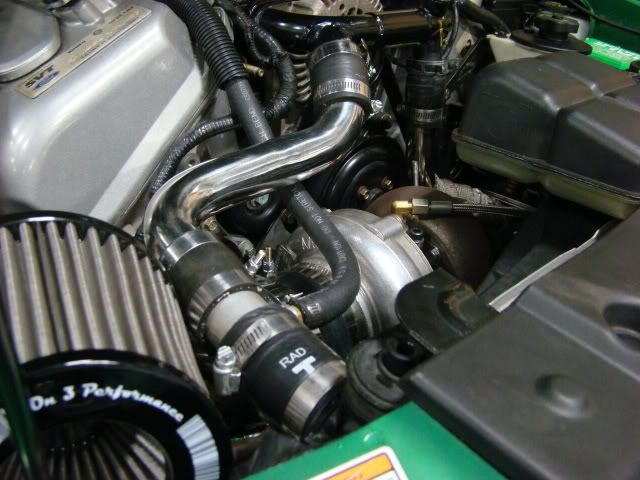

On 3 Performance 2v & 4v Forward Facing Photo Thread

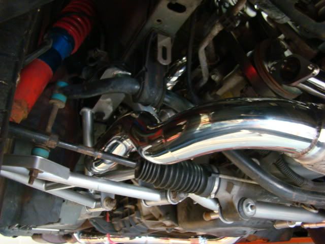

Figured I would start a new thread so that the photos don't just get burried in the middle of the current thread. It only allows so many photos per post so I couldnt add to the first post either. Im going to reserve a few posts as well after this in order to be able to keep the photos at the top and also be able to add to it over time. These first photos are all the 4v and Ill get some of the 2v next. Also just picked up a HD gopro camera so Ill try and get some new video as well up as soon as the weather decides to quit raining
This cold air setup is not included in either of the 2 or 4v kits, we are considering to build them and make it an option. Let us know if you would be interested so we can consider to put it into a production part

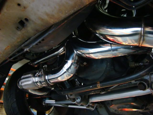

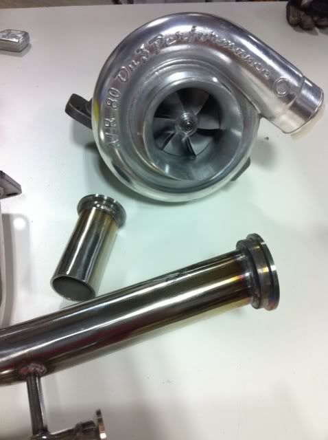

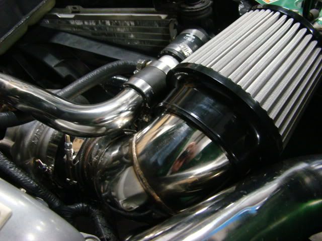

Continuation of the 4v photos, this is the optional cold air intake setup and custom filter we are thinking about producing. If there is any interest in it, let us know

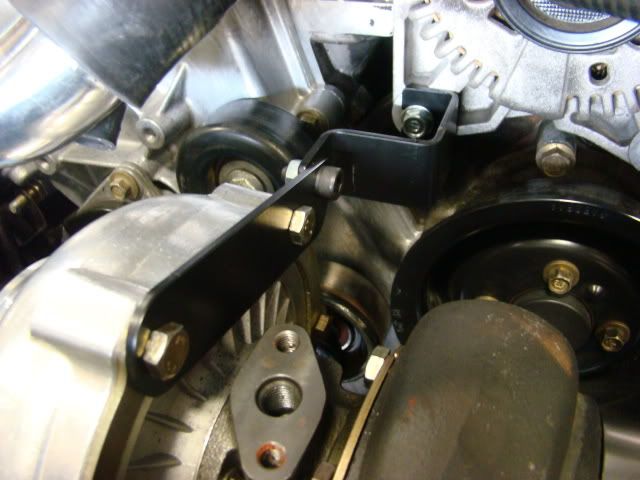

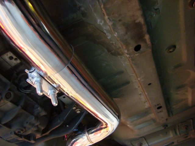

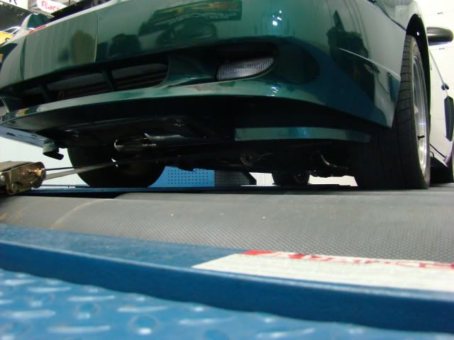

Here are a few photos of the 2v kit, both 2v and 4v kits route the same way. Ground clearance is awesome on the setup and everything really tucks up about level with the oil pan. Note we don't have the front plastic spoiler that goes to the core support. If we had that on both cars, you wouldn't even see any of the tubing. As for power gains, we were able to pick up around 30hp/50ft lbs mid range over the 1st generation kit. Both were making around the same peak but with the boost coming in earlier, it really shows with the mid range power gains. Also the new intercooler tubing is 6061 now instead of stainless. Headers are going to be seamless mild steel and the merge/downpipe will remain to be manufactured from 304 seamless

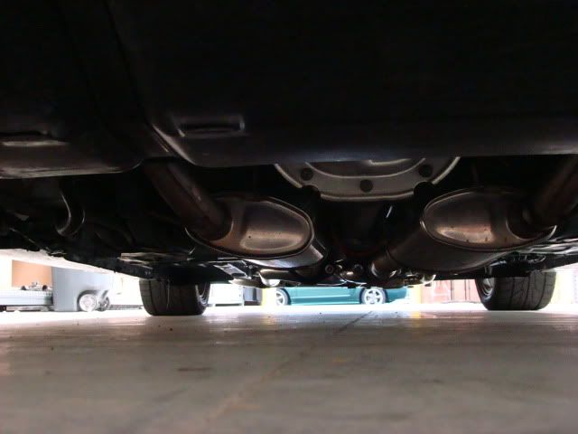

one more

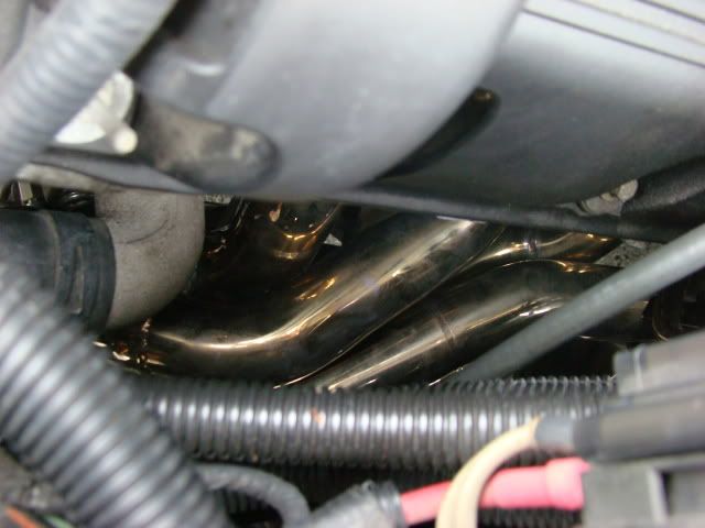

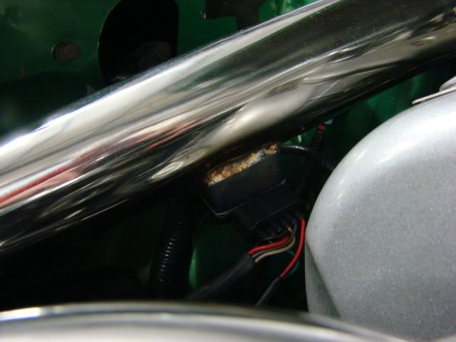

Do you have a more detailed undershot of how the headers go over the K-member i'm trying to see if they will go over the MM kmember. Thanks

Hehe order with on3 new vband 44mm wastegate, should ship anytime . They are welding vband flange

By the end of next week, we should have the kit started to install on the shop car which is a 4v built motor notch. So those interested in doing the kit on the foxbody we will have more details. I just talked to another customer that did our 1st gen kit on a fox 4v and he said he didnt even modify the hotside at all which was suprising to me.
Here is 2002mustanggt ( suresh ) upgrade kit, we just modified it to take the new vbanded 44mm On3 wastegate. Also below you will see the photo of our new 67mm and also have a 76mm Ceramic Ball Bearing turbo option now

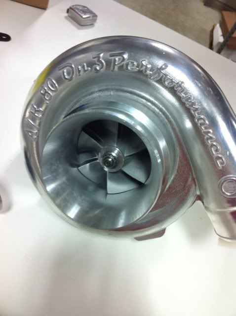

Chad, how much are those new Ball bearing turbos you have going for? I'm considering uprading from the old journal bearing 70mm that came with my kit. Do these BB turbos spool up quicker?

New ceramic ball bearing turbo is $689
Rob, we have a track rental on the 10th at Trails. If the weather will hold off, I plan on taking the 4v out for a few passes

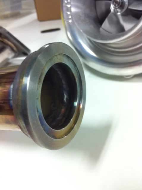

Chad when you mounted the 44mm v-band flange did you change the pipe size from 1 1/2 to 1/3/4 or keep it the same?

Its actually 1 3/4" on all of the kits to the wastegate so we just keep it that way and weld on the flanges

I just purchased one of your new 4v forward header kits and my wastegate pipe is 1 1/2 so is that wrong because I measured to double check?

The only way you can get a measurement of around 1.5 is if you are going with i.d and the tubing is measured and gets size from o.d
