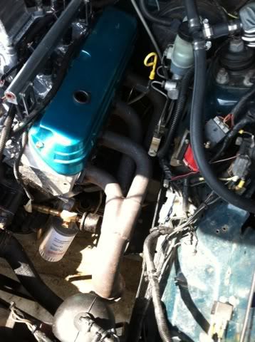

im trying to figure out a clean way to run a dist block that comes out of the motor for my turbo oil feed line and oil pres gauge. the stock one is junk and the brass tubes and t-blocks i have is heavy, huge and ulgy.

I'm gonna use a stock sending unit adapter and drill and tap two holes in the side of it for my twin setup.

Just like above posted, thats what I always do, just drill and tap the stock log.. if you dont want to do that go to mcmaster.com and search "manifolds" and browse their selection.

My tt kit came with the same log pictured above ^^^

That's what I was afraid of. Looks like I'm gonna have to find a stock junker for a replacement.

Oil Filter Sender Adapter - 3/4 unf-16
I have this for my Gauge and for my future turbo build. Real easy and works well.
