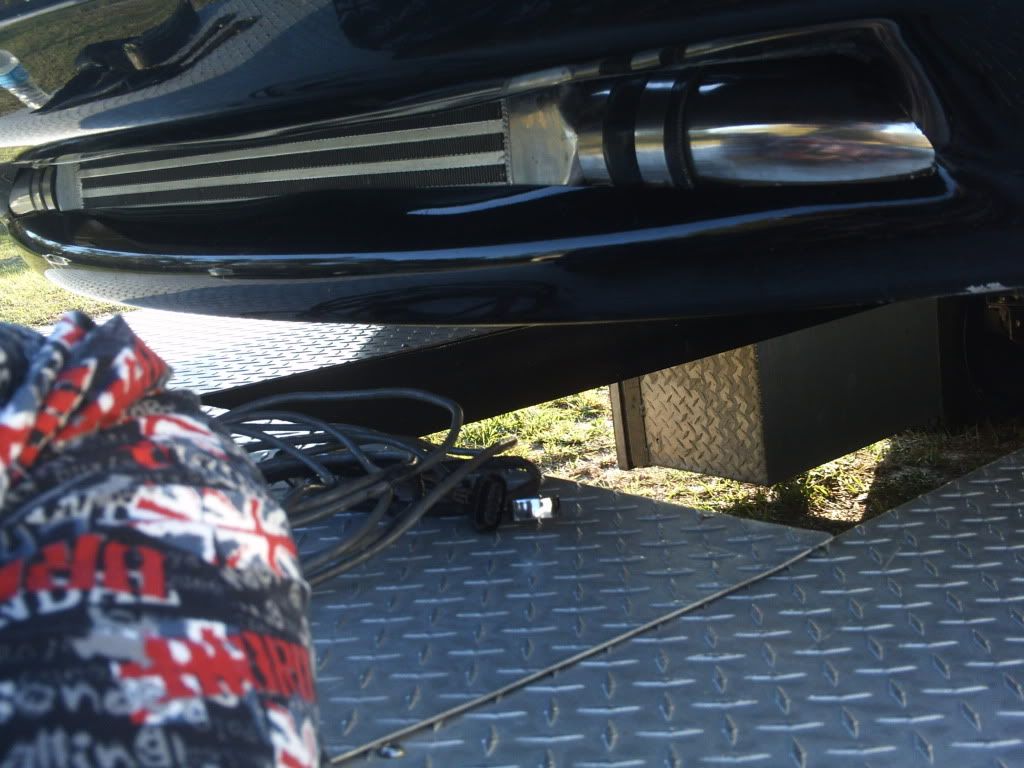

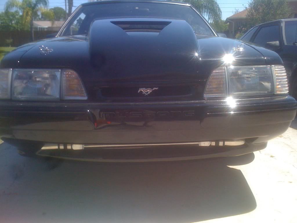

Looking for mounted intercooler pictures, also post up anything you had to modify, remove or cut to get it to fit. Thanks!

3" thick intercooler. Didn't have to trim or cut anything to fit. But I did open the main front scoop of the bumper a little to get more airflow over the intercooler. O' I did have to relocate my power steering cooler that usually mounts in front of the radiator.

I cut out the teeth, screwed the top to the bumper and zip tied the lower lip to itself to spread it open.
