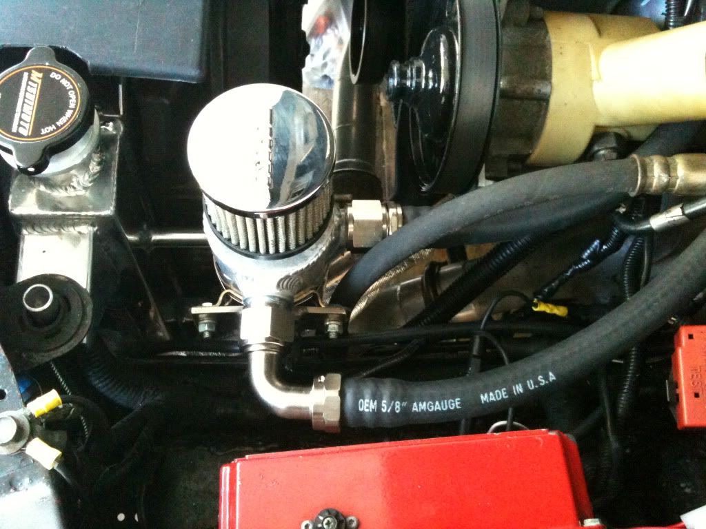

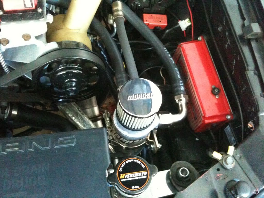

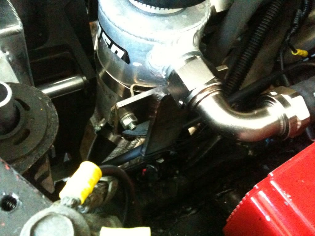

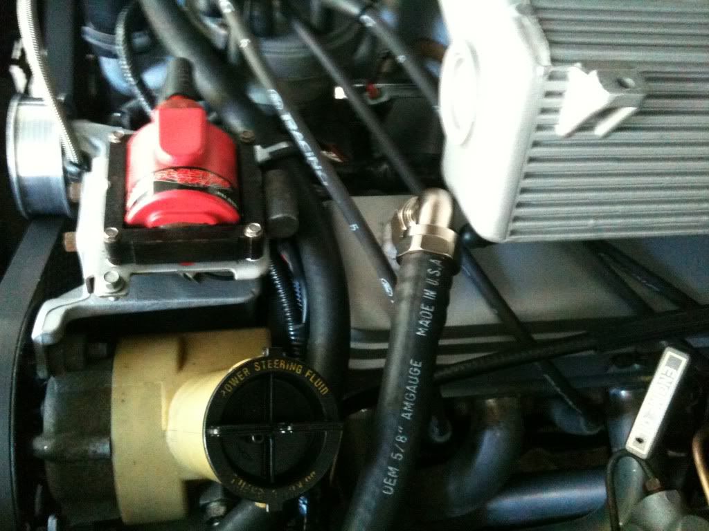

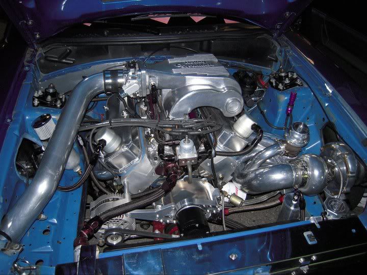

What size fittings and hose are you guys using for catch cans? I'm currently using 8AN fittings and hose but get a bunch of blow-by from the catch can breather. Wondering if 10 or 12 is needed, I'm only running 6psi?

I ran two -10 lines and my breather appears to have some blow by as well
You mind attaching a picture of your setup? I might be taking my VC's off and welding some sort of baffle under the vent hole. I'm not too interested in tearing it apart and running bigger lines and hoses.

I have been told -10, -12 is the way to go. I run -8 on mine but never really ran much boost like you. It is on my "to-do" list now that I plan to turn the wick up.
One day I'll likely do a evac pump, but to cheap right now haha.

I run these breather/baffle deals on my valvecovers. They have screens and a mesh filter inside. I'm sure this helps, and part of the reason I never have anything in my catch can.
Hope this helps some

Don't have any good pics right now. I welded a -10 fitting on each valve cover and ran them to a tee, then into the breather/catch can. I will be putting baffles in next time I pull the valve covers

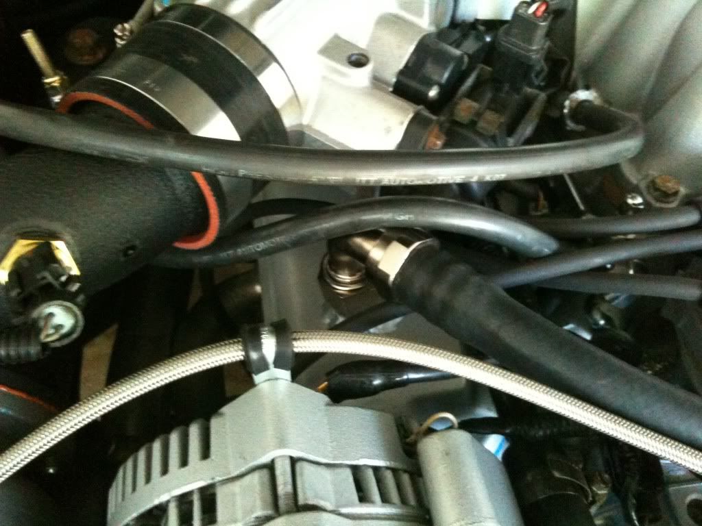

I realized the fill neck hose to TB was still connected. This has been removed and I now have much less blow-by. I'll run it this way for for a couple weeks and see how thing go.

I found that my TB to fill neck PCV hose was still connected. I've since removed it and am in the process of getting my gate to control boost below 6-7 psi. We'll see how it goes.

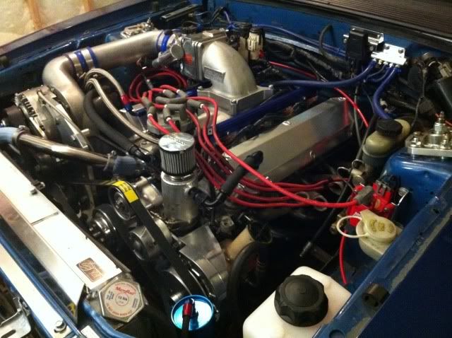

That's just a Novi 1000 spun to 11psi, with a shot of meth...dyno booked for June 3rd to get some real numbers!!

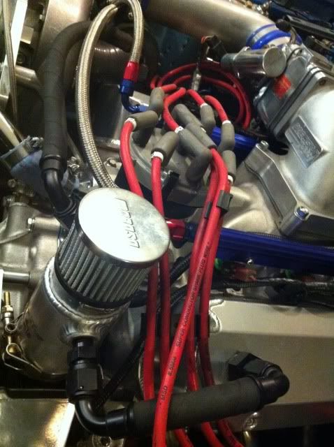

I have a set of very similar valve covers with 1/2 NPT bungs and a fill cap already installed in them that I will be selling shortly.
They are on the ones on the car in the picture.
Shoot me a pm if you are interested, would be really easy for you to set the rest up.
I also use black pushlock....subtle stuff vs. braided.
