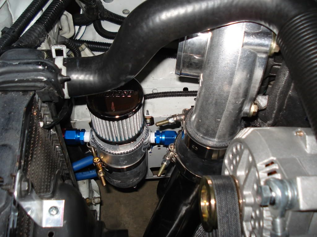

I just drained my catch can after doing a couple weeks of tuning and found about a cup of oil and some moisture. How much are you guys seeing and when are you draining these? I'm thinking of installing some baffles under my bungs to limit the spray of oil into the vent hoses.

Are you guys with no oil baffling near the bung or preventing oil from splashing into the hose?

put some baffles under the bungs and I bet you'll see a lot less oil in the can.

I dont have a baffle and I dont get any oil in the can

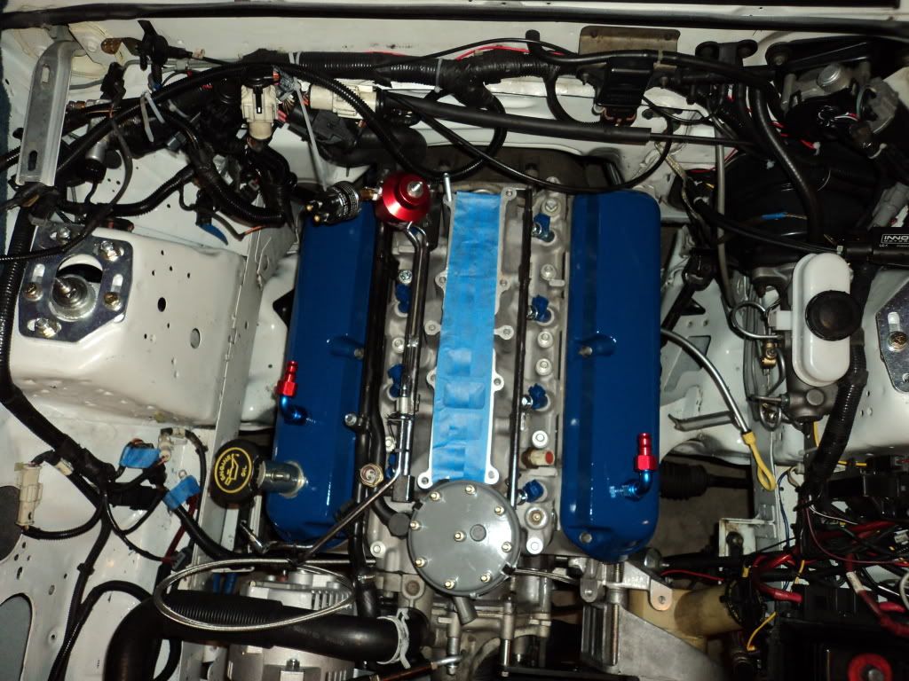

Where's your vents located?

The AN lines are hooked up at the very front/top of the valve covers

8an, one on top towards the front of each valve cover.

I wonder if one or both of the fittings are right above a rocker and pushrod??
And oil is squirting up into your c/c line..just a thought

Thats kind of what I'm thinking at this point. I drove it for 5 miles under no boost and found about a tablespoon of fresh oil in the can. I'll pull the vc's off and look where they line up. I may have to weld a baffle under the vent hole.

I just realized my oil fill tube hose was still connected to the TB port. This has been removed and I have much less oil in the catch can after a good day of testing. I'll keep it this way for a couple weeks and see how thing go.

I also got my wastegate boost source routed correctly and keep the boost under 8psi. This along with not boosting the crankcase have got rid of all the oil in my catch can.
