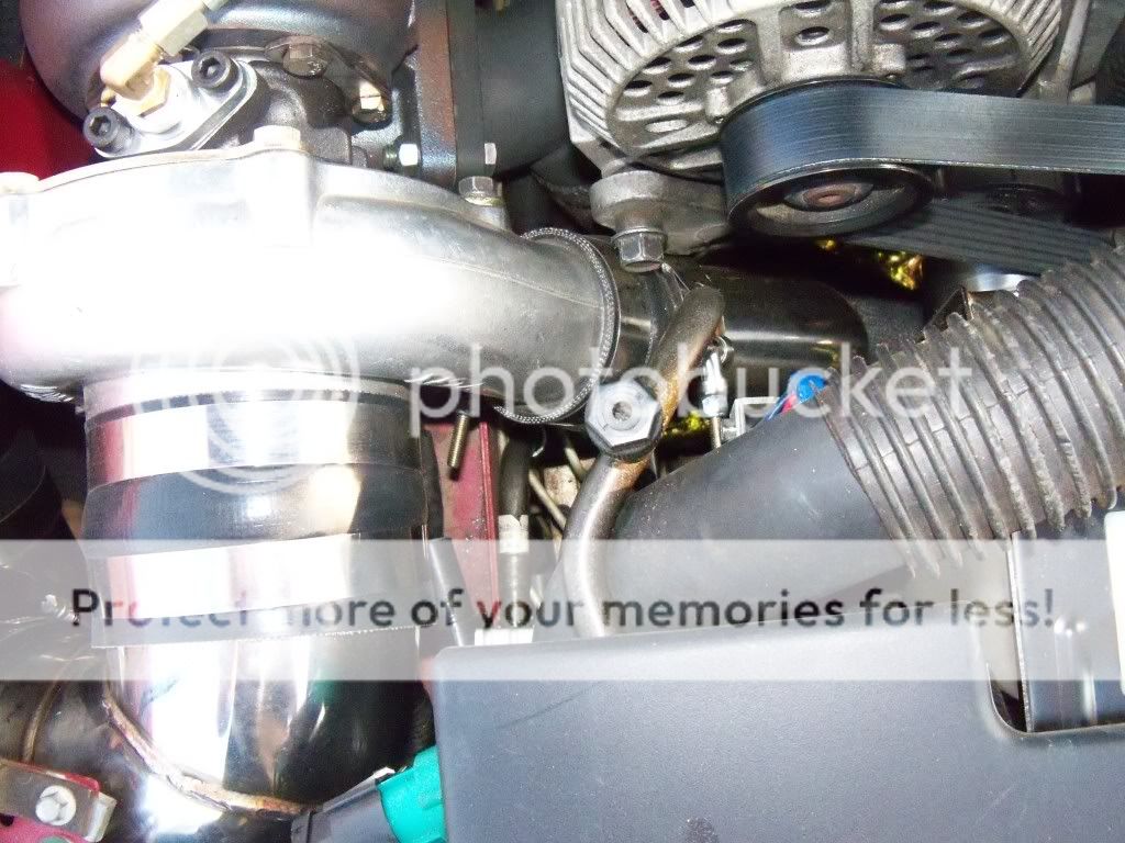

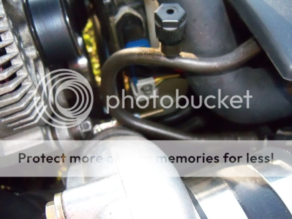

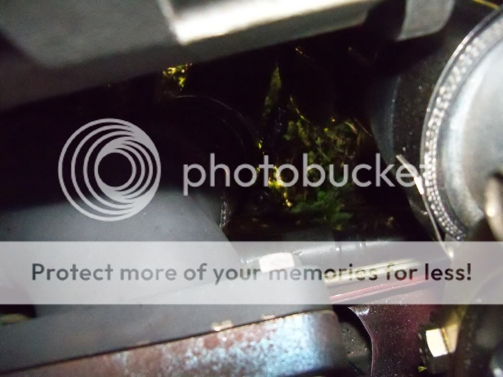

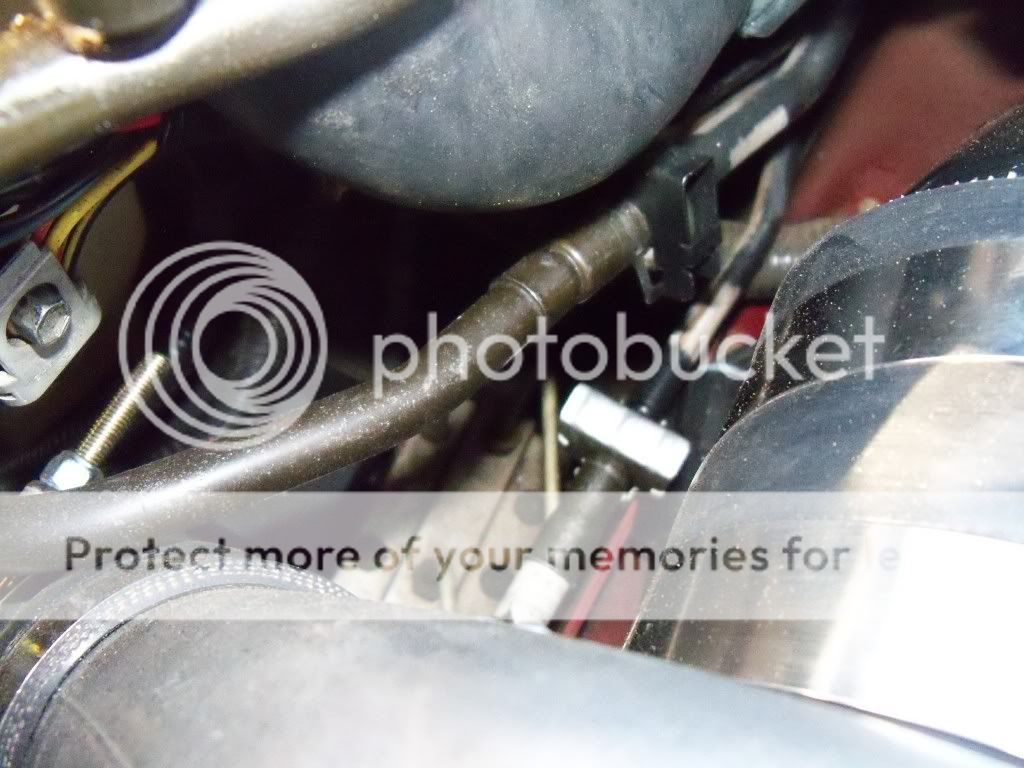

I moved the top line up and towards the radiator a little and moved the lower line down some and used a clamp to hold it down to the inside of the framerail. I will snap a pic in a few minutes.
9389coupe is offline
post #9 of 19 Old 04-24-2011, 07:31 PM
Trader Feedback: (43)
Join Date: Feb 2009
Location: Chesnee, SC
Posts: 430
Sorry this is the best I could get on pics, hope they help
