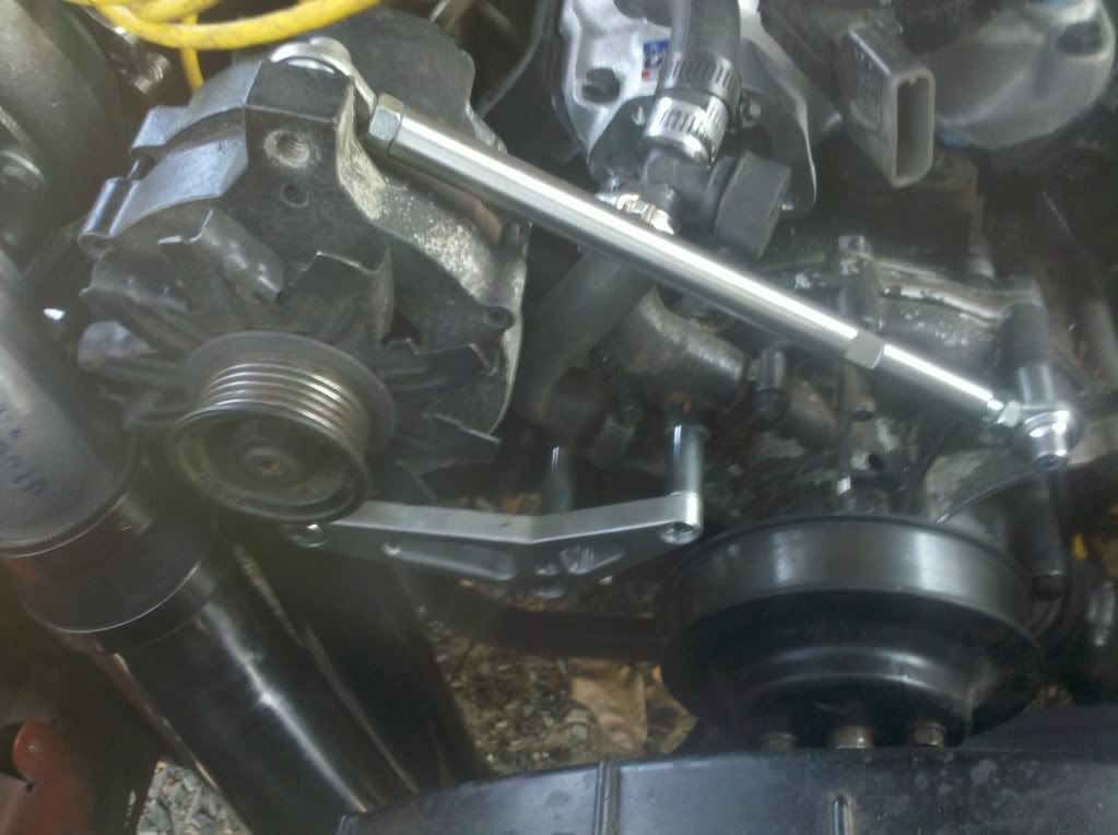

Does anyone with the on3 kit knows how the alt bracket goes on because mine does not fit with the spacers. pics or any kind of help would be great thanks.

Not sure how it couldnt fit unless you have the spacers in the wrong places. This is mine

I think i do and thank you very much for the pic.

No problem. They go from right to left, 2nd biggest, 3rd biggest, and then the longest one. Shortest one goes on the bolt for the tensioner on the water pump.
