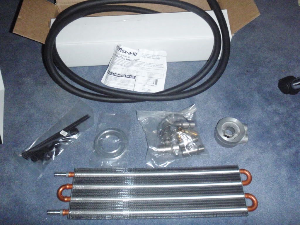

How should I mount my oil cooler in front of the intercooler . There are plastic zip ite looking things but i will have the remove the intercooler to install the zip tie things
This was from when i was installing the turbo . Its just set in front of intercooler . I ended up not installing it then and now i have gas in my oil so i have to change the oil and wanted to install the oil cooler at the same time

easy... use the stock mounts on bottum of inter cooler ...take 1 inch flat stock aluminum,drill 2 holes one hole at each end(measure )attach one end to intercooler bottum.bend other up so it looks like a L,, get 2 p clamps( one for each side) and put around oil cooler tubes and bend aluminum to fit get bolts and bolt together ,,,,it will be trick...........should look like little L brackets when done with the p clamps bolted at on end and other to intercooler...HERE ARE WHAT YOU NEED
