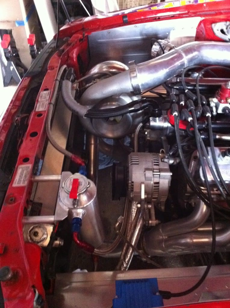

please find me an air filter
Tony K is offline
how about a birdcage with a towel wraped around it..LOL!!! setup looks great..
