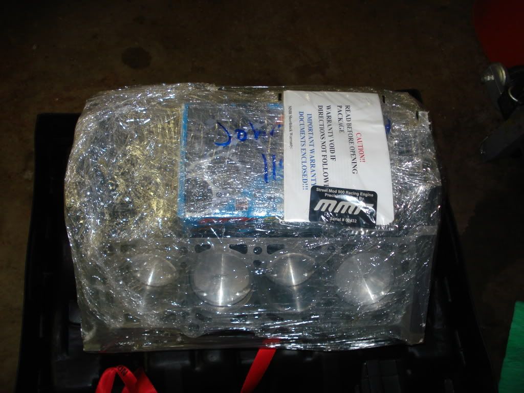

Hey I am in the process of swaping out my old engine and putting in my new MMR mod 900 short block. I wish I could post pics but I'm a new member. How long do you have to be a member to post pics? Anyway here is a rundown of my setup.
