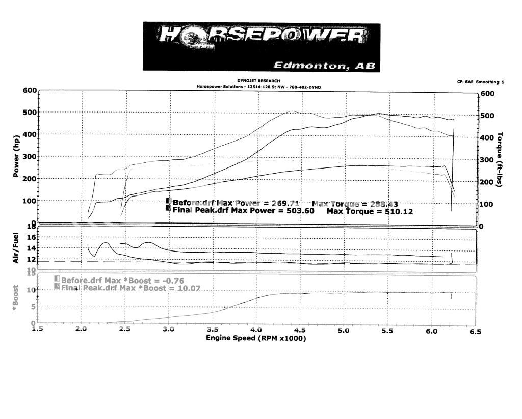

Damn it i just remembered that on this pass i went to the screen to show the numbers. 504hp/510tq, 14 degrees total timing, 10psi, 11.5 A/F ratio. I will post up a good scan of the graph and also a comparison to what the car did stock....well, stock ish....it had an intake and exhaust.

I would like to get the Dyno graphs scan in color but for now i have them in black and white...Gimme 2 secs

Sorry the quality is so ####ty. I put up the graph that also shows my stock dyno run for comparison.

dayymmm,,AWESOME NUMBERS!!!!!look at the torqueWOW!!
