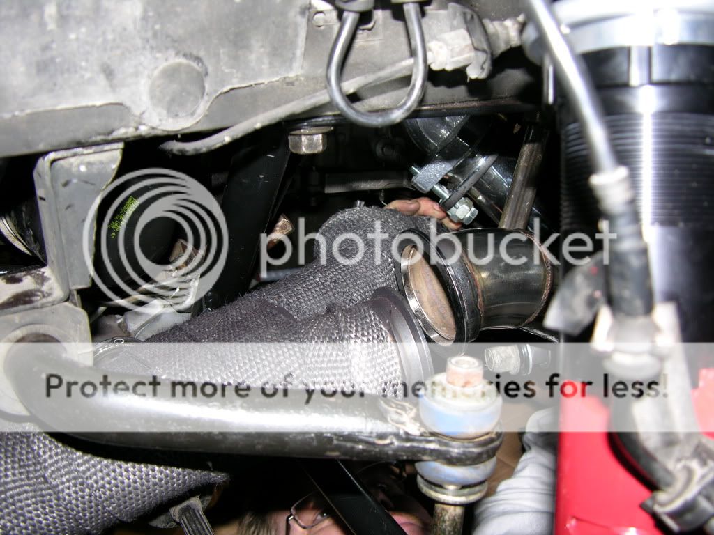

So i just purchase the on 3 performance turbo kit..... Working on the install right now. was woundering if anyone else has ever gone through the troubles that im going through on a 4v? So far im on my second pipe and already have troubles its almost like the engine should be tilted more to the drivers side... from the engine mount bolt it is seating directly in the center. Instructions from the company wouldve also been nice still working on getting those, beings that im paying to do this in a garage i would like to get this done soon as possible. any advise from more experienced people would be great.

When you exhaust wrap i soaked the roll in water it made it easier to wrap ..make sure you pull it tight ..the tighter the better. I used plastic zipties until i was done then went back w/ metal ones.. Also if you run out of metal ones in some spots i used hose clamps which worked out a hell of alot better..
-Get someone to help!! you install the pipes and loosely put on the v-band clamps just enough to hold but still be able to twist the pipes
- For the cold side i followed the directions and fit all the pipes and then mounted my intercooler
-I left all the pipes snug then went back added a small amount of copper rtv and tightened everything up.
The turbo bracket i think might mount using the bolt of the alt bracket and then to the turbo.. Not sure b/c i made my own

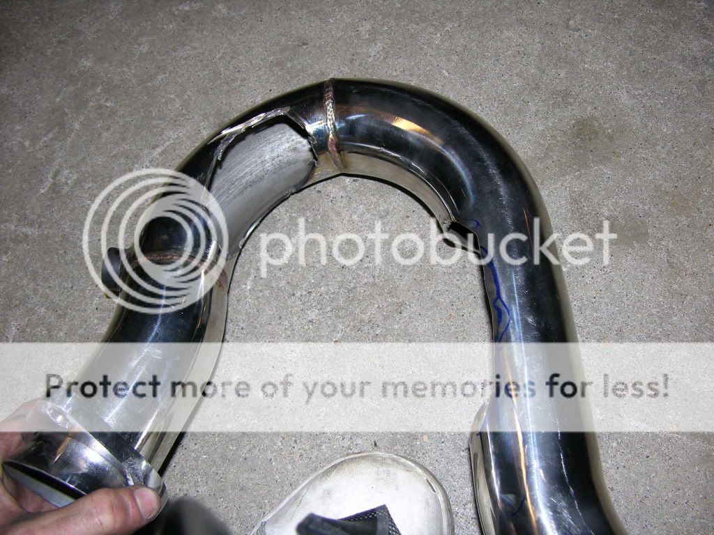

either one of you have troubles with the drivers side pipe to merge pipe or is that what your saying you made a relief cut in?

The horse shoe shaped pipe that routes behind the dvr side rear k-member mount i made a relief cut in 3/4 of the way through , reinstalled it and used the vband to get it where i needed it, tacked it and then welded it .. Did this b/c there was no way it would mount up to the merge pipe correctly..
In my application this could have been b/c i have urethane motor mounts that dropped the engine a little, production differences or the pipe was just crap ..who knows ..now it seals ..
Now starts the fun part of clearenceing everything so that no pipes hit anything..i noticed i need to adjust where it it passes through the bumpsteer kit and sway bar..it hits my steering rack boot..again maybe b/c of my motor being 1/2" lower b/c of the motor mounts.

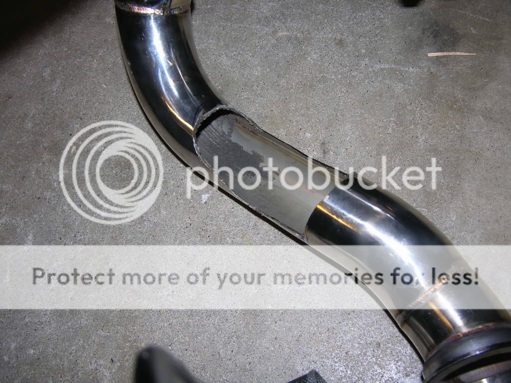

Ok so after cutting peices out of pipe off driver side in order to get it to even get i close which it still would need more for clearance reasons with plans of patching holes closed..... come to find out the pipe needs to be about 2 inches longer and bend down like an inch in order for it to even meet up with the merge pipe

I used exhaust gasket material, it has metal in it. On that U shaped pipe, i took a hammer and some heat to it. No more rubing or vibrations.

^^ at this point it might be better to buy a couple mandrel bends and redo the pipe.

i would agree,,, might want to make new ones!

Wow that looks pretty rough. As long as I don't get delayed anymore I will have mine installed this weekend so I will report back what I find with my kit. Good luck

Turbo99svt damn that pipe is way off!!! mine was off a little about 1/4 " ... I know you probably do but are all the pipes loose that attach to the merge? and are the pipes that connect to the manifolds loose? it took me a while of playing around w/ the pipes to get them close..

My lower radiator hose sucked , i had to cut it and get a 90 degree hose from advanced to make it work .. I also just purchased a stainless universal hose from summit .
Same thing i did with the merge. Loosened all the pipes and then used a C clamp so that the T bolt could go through enough for the nut to be threaded in. I didnt get a stainless universal hose just the one from advanced. I will upload a picture tomorrow of how its routed. Its close to the hotside but i have been giving it some boost several times and drove for an hour straight with no signs of damage to the hose.

No offense but that looks absolutely horrid. I agree, time to buy some mandrel bends and get it fixed right.

No offense taken i agree 100%... And there would've needed more cutting and patching even after all that. And no the was nothing hooked to the other side of the merge pipe and both flanges were loose.

^ I had the same fitment issue in my build. I bet the jig that they use to build that piece is losing its accuracy.

What did you do about fixing it ...And did you ever call them because Both Chad and Mike said they have never had a fitment issue such as mine.

Thats the same response I got, "worked on our cars so there's no reason it wouldn't on yours", so I must be doing something wrong. The reality is that jigs can change shape after repeated uses because the piece being welded tends to pull on the jig especially if the fitment of the pipes and vbands is a little off. I fixed that pipe by cutting ~ 3/4" off the straight section then splicing that 3/4" piece in before the forward v-band (lengthening that leg of the bend) . The straight section that the 3/4" piece was removed from was reconnected with a sleeve pipe (shortening the total length).

of course chad never had a fitament issue like yours or anyones for that matter, he is the turbo god and were all just lucky to be on the same earth as him.
your best bet is to just modify any part of the kit that needs it and forget all about chad and on3- once they have your money thats the end of your relationship
