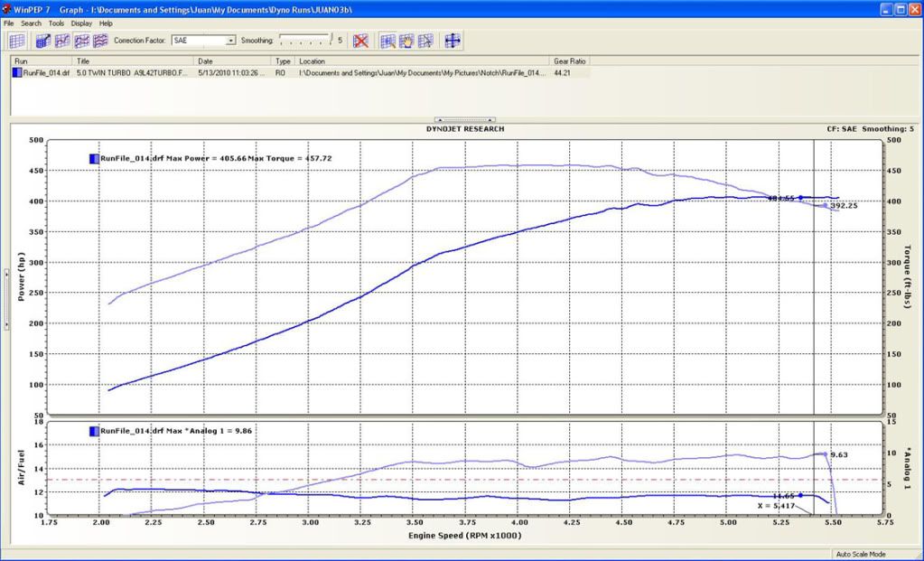

It's been a long journey, but the car is finally fully tuned. Since my last update in the other thread, I discovered one of the Ramcharger fans I had was bad, so I went with a MarkVIII fan with 8g wiring and a 75A relay. I also went with Accel Extreme 9000 plug wires w/ ceramic boots after burning 3 Ford Racing wires, one bad enough to drop a cylinder.
Here's how it performed on the dyno:
http://s175.photobucket.com/albums/w...tchDynoVid.flv
I'm happy with that. I'll be headed to the track tomorrow to get some REAL numbers.
