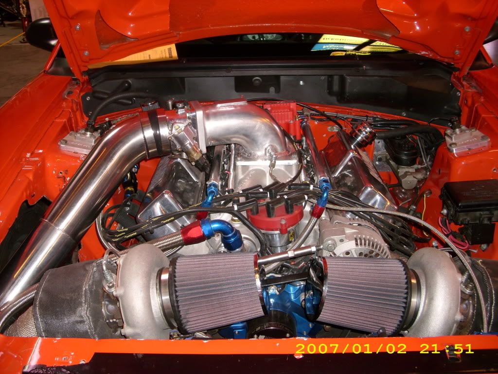

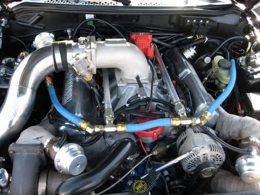

I was making 1382rwhp @ 31 psi, 427 cubes twin PT78's with 1-5/8 flipped.
With the new car I made some new 1-3/4 headers and made a couple other small changes had it up to 28 psi and made 1352rwhp.

That is some good information. I always thought 1 5/8's would choke a car making that kind of power. Similar setup in the new car with bigger primaries?

Pretty much. I relocated the turbos no difference I'm sure. Put on a larger A/A IC and went from a 80mm to a 90mm throttle body. Also went from dual 4" steel exhaust to dual 3.5" aluminum exhaust.
