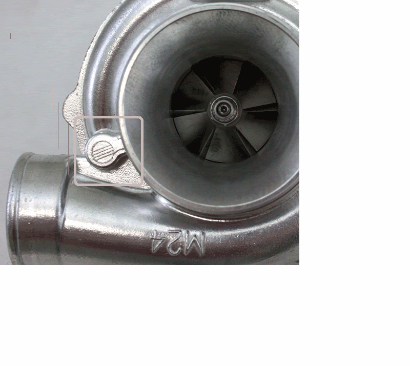

yea, i know the ports on the wastegate, and what they do, i got a MBC coming next week. Rite now i got around and 8psi spring,
since its a rear mount setup, i ran and 8lb'r, if it was a regular setup i would have ran a 6-7lb'r.
And as for the MAF, im not actually using a blow thru, i'm using and 80mm C&L, calibrated for stock injectors, cuz i'm running stock injectors, i had some problems in the beginning, and all i had to do was clock' the MAF to the outside of the 45* silicone coupling that connects the MAF- thru the fender well, to the pipping. And it ran fine. But it still could be causing problems.
Like you said, i'm gonna connect a seperate line from the side port of the w/g, to the compressor, except, the T70 dosent have a nipple/port, to conect the line to. so I gotta drill and tap it, do you know what size it is? You can see were it's suppose to go, my turbo looks like this,
But i need to put the port in like this,obviously,
i was gonna drill and tap it for 1/4 npt fitting, same size used on aircompressor stuff, but its a lil' to big. You know what size it is?

Mine looks like its 1/8 inch NPT

Well ive come up with some variables, both from you guys, and from me,and a check list of what ive accomplished.
some possibilitys, & things im gonna check out, look into, and maybe solve.
1:spark plugs & gap,(change bosch to autolite & gap to .32")
2:timing/igniton,(taking out to much, or spark blow out? hookup 3-bar to pms)
3:fuel: need more,(bigger injectors, regualtor extra inline pump?)
(max boost of 6psi)
4:MAFpegging?, bad signal from elbows?need blow thru?)
4: STOCK MUFFLERrestricting flow/creating backpressure?)
5: BOV (opening up under boost)
6: LEAKING BOOST: Not gettin any boost in intake manifold
(gauge not showing, possibly wastegate opening to soon?,because its getting its signal from compressor, not intake manifold?)
(or leak in coupling or piping?)
7:stock MAP sensor:?
8:adaptive ability: of the ECU learning from 02s
AND ANOTHER ONE I THOUGT OF,
8: EGR: (stock egr system still hooked up,maybe boost pressure getting past egr vavle on manifold? at hi rpm?)
(did have a DTC for egr one time.)
Already eliminated problems:
Would not even idle/run/rev:
fixed by: Clock'ing MAF' to outside radius of 45* coupling that connects it to boost supply.
Wategate not opening at all, causing motor to completly fall on its face at mid range:
Fixed by: hooking wastegate supply directly up to compressor, instead of manifold.
Bov not opening, geting compressor surge:
Fixed by: supplying its own port off of manifold(port that use to be connected to pcv) and also increasing size of supply line.
most of the drivabilty problems:
fixed by: taking out timing, gapping plugs to .35 from around .38,
just to go over again,Problems still occuring,
Showing no pressure on boost gauge, but hear turbo/wastegate working,
Falls on its face/chokes out when throttle is opened quick to WOT,(trompd)
No power, dosent pull like it should starting mid up to hi rpm,(wont rev out)
CAR Pulls PERFECT when in fifth gear LOW rpm,(lugging)
with the pedal to the floor, (HI TPS%,)
thanks guys for your help/opinons/info.
I'm gonna try a couple things on this list here, and ill see what happens.
