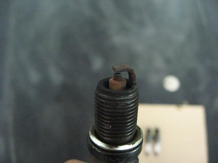

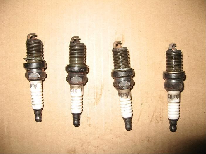

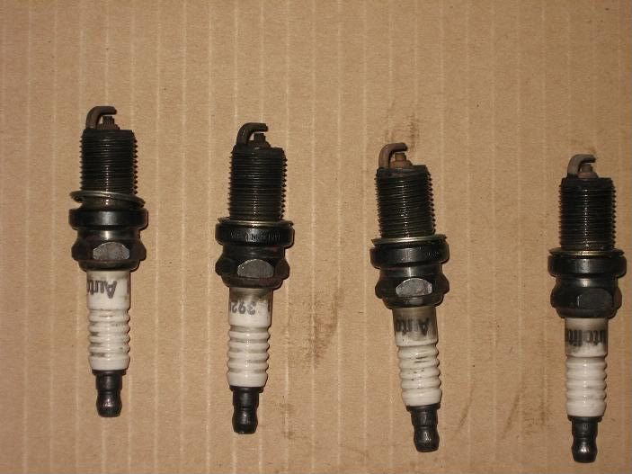

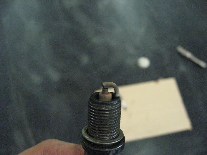

So today I pulled my plugs (3924's) to see where they were gaped, they were all at about 35 so I bought them down to 30
Here are plugs 5,6,7,8:

Have you tried clocking the mass air meter? also id recommend running a colder plug and closing the gap just a little bit more. On just the stock ignition i was getting spark blowout around 4k and up gapped at even .028". I have the 3923's from autolite for my aluminum tw which is supposed to be good to 550rwhp on boost. Try bumping timing up just a bit. 6 seems low esp if you are running it with the spout out. If all else fails set it to about 20 degrees and leave the spout connector out. Thats what I did untill I hooked up my xpi timing lock.
