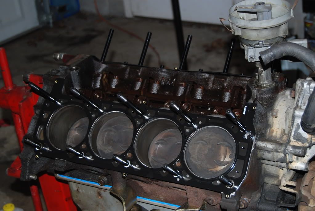

Car currently has a freshed 302 with GT-40 iron heads, Explorer intake and "E" cam. Car runs good but needs a bit more. The build is somewhat special to me because it's my first one. I've owned a few cars before but this '88 is my first one that I've changed more then a few things on.
The actual build should start early Aug if i get the rest of the parts. I'm only missing the waste gate. The hotside it totally custom and being reused from previous owner's build (was on a 351). I have a set of 42#'s, LMAF (which will be used in draw-though), and a SCT chip.
My goal with the car is to see ~450whp on the stock block, which I don't think would be too hard. The end result is I want it to be a 10-second street car that I can just get in a drive and not really worry about it.
Well here are some currently pics of the car:
Some pics showing the h/c/i:

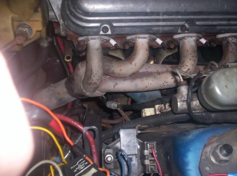

Here a couple starting pics, took the stock exhuast/headers off and started out on the pass side since the turbo will be there.

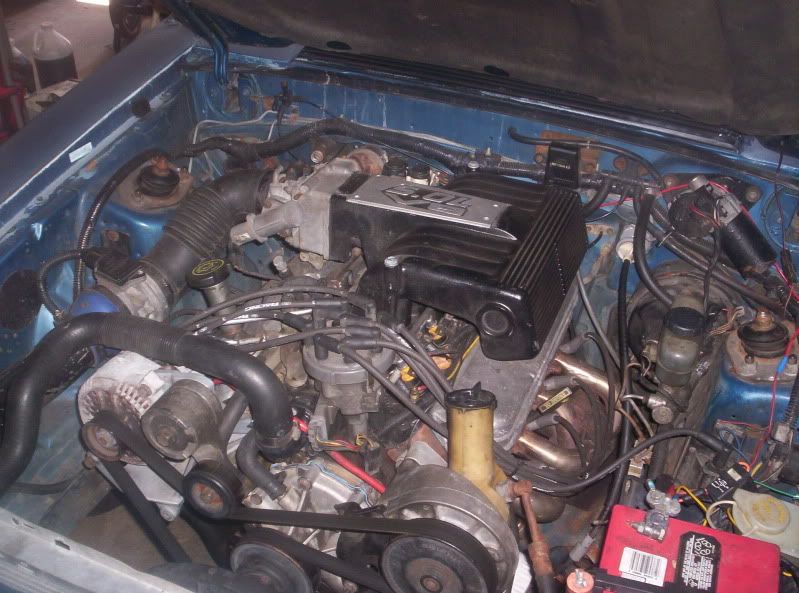

Hotside all done and painted. Boost and Widband A/F gauge's are in, new injectors are in.
Decided to go with silver hi-temp paint instead of black:

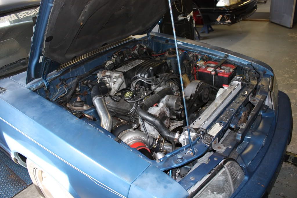

All done.

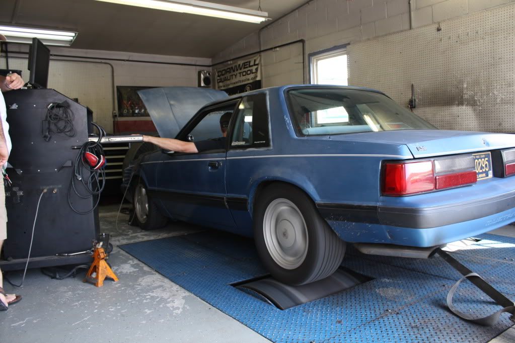

Going to the rollers for a tune and dyno on monday. Shooting for 500whp. Street tune will be more friendly of course.

Few pics from today, I'm uploading the video now too...

Not too shabby man! It really jumped hard at the end of the vid. Get the blowthrough and bring that bad-boy on STRONG.

It's interesting really.. cause it's currently half the boost I want to run lol
1st is pretty useless, 2nd doesn't really grip but you can pedal it, then 3rd you can mat it and it really starts to sing.
I'm thinking mid-end OCT I'm gonna go back once I get the parts installed. The tuner wants to push 14/15 psi for a race tune haha It was spiking around 16psi on the dyno due to a crappy boost controller (one of the problems) and I'm pretty sure it was breaking loose on dyno...
Basically, I need to get a good boost controller (already ordered it, Hallman pro kit), a additional fuel pump (going to run a inline, plus my 255lph in the tank), and change to a blow-though setup with the MAF. Currently it's in draw-though with a 90mm Lightning MAF, but when I get out of boost it's backwashing the MAF causing it to run super rich and stall (not fun when coming to a stop lol). So I'm changing to a PMAS MAF in blow-though setup. Currently, while in boost the car runs like a freight train, it's awesome.

Originally Posted by Speedy911 View Post
What head gaskets are those? They sure look pretty.
Fel-pro MLS gaskets.

post #35 of 70 Old 10-13-2009, 08:00 AM
nmcgrawj's Avatar
Join Date: Aug 2004
Location: Ann Arbor, Mi
Posts: 1,536
Looks great! What exhaust are you running after the downpipe?
