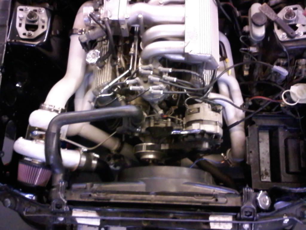

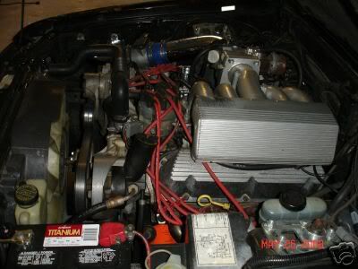

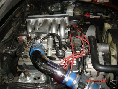

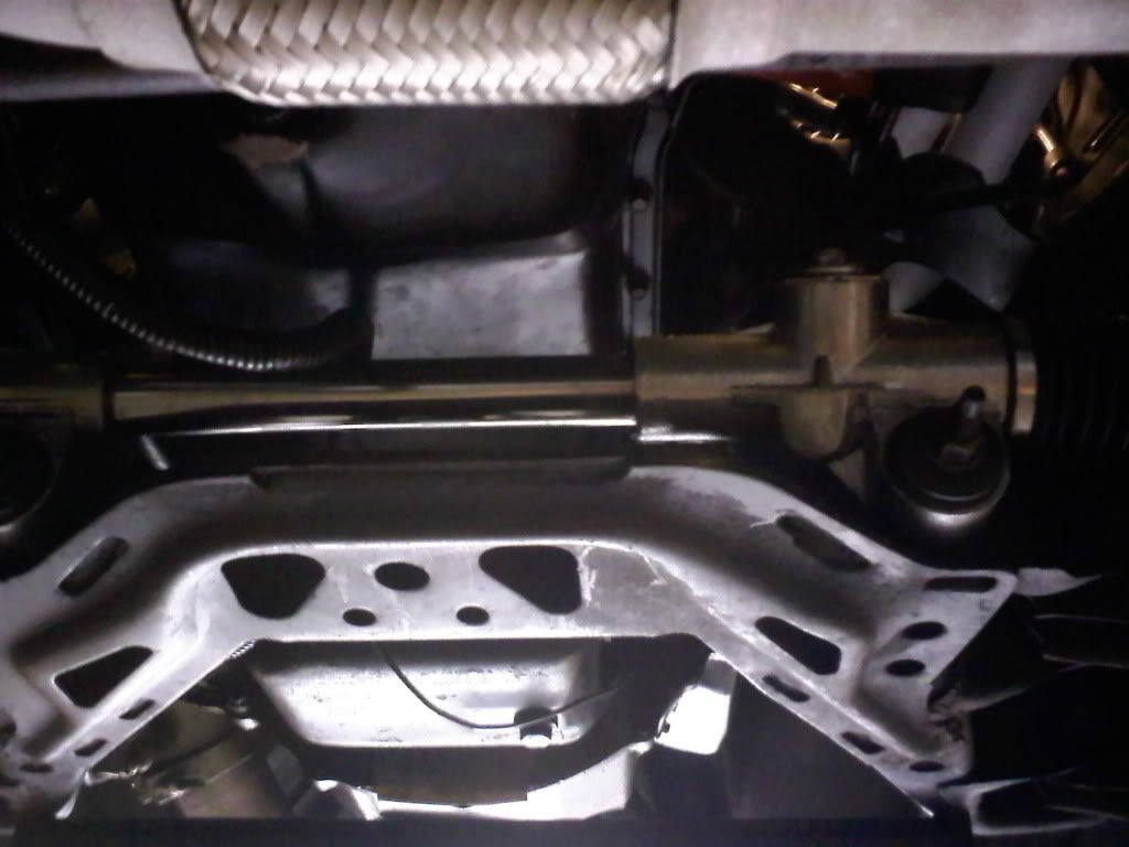

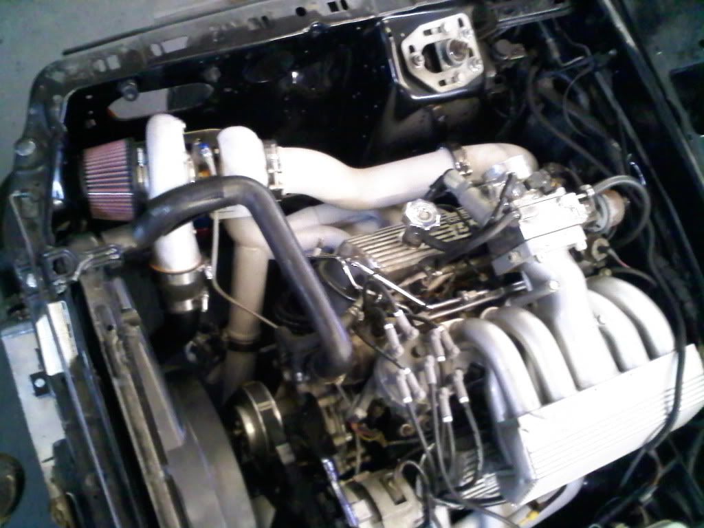

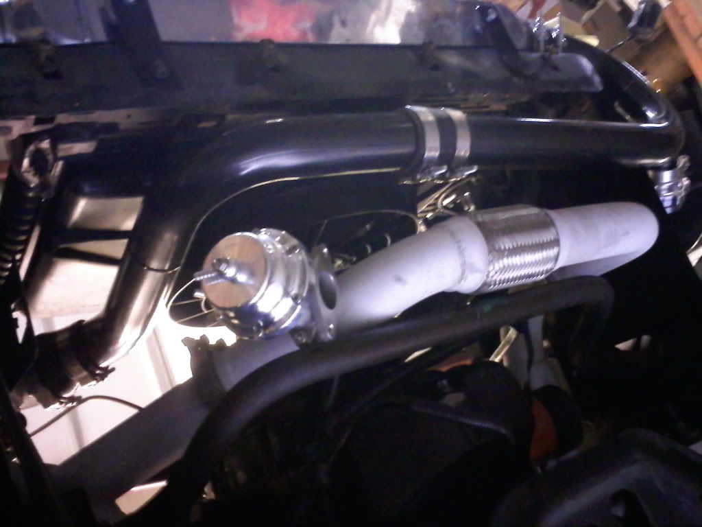

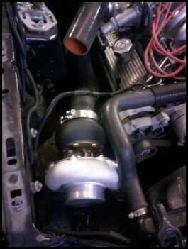

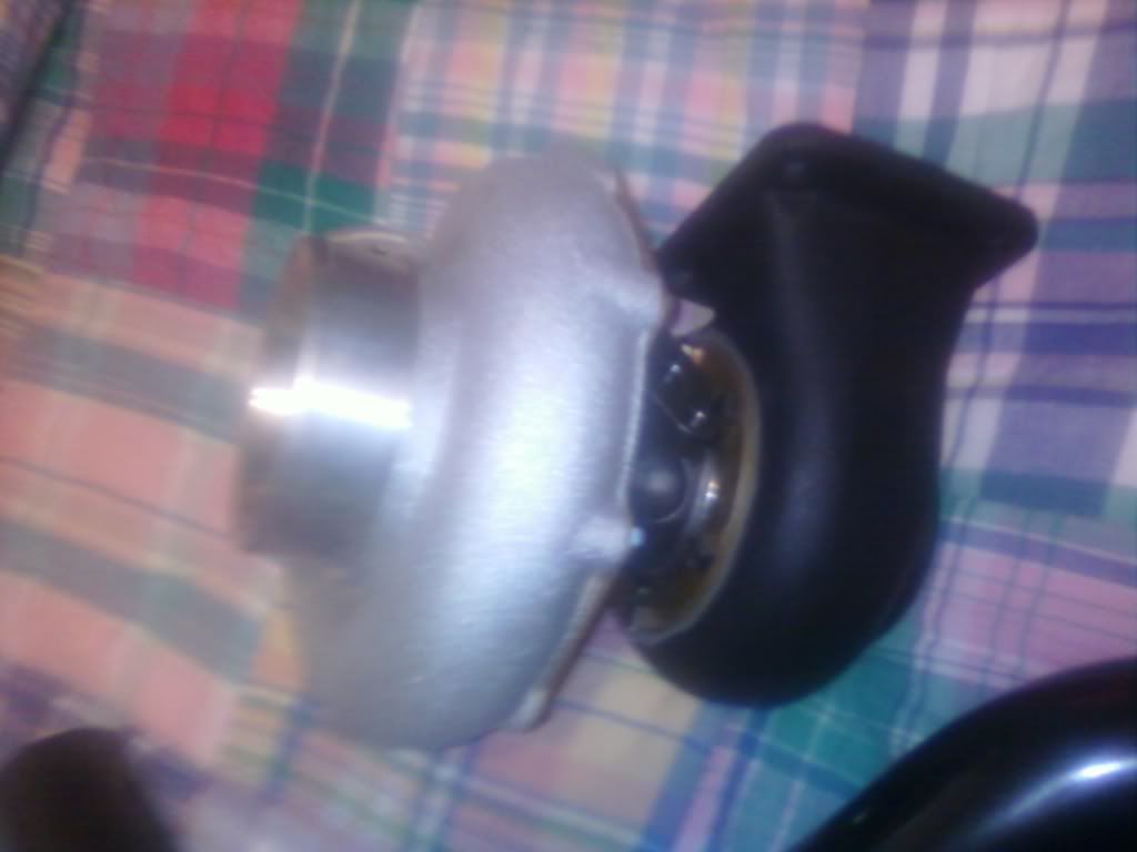

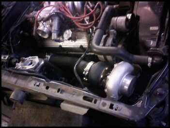

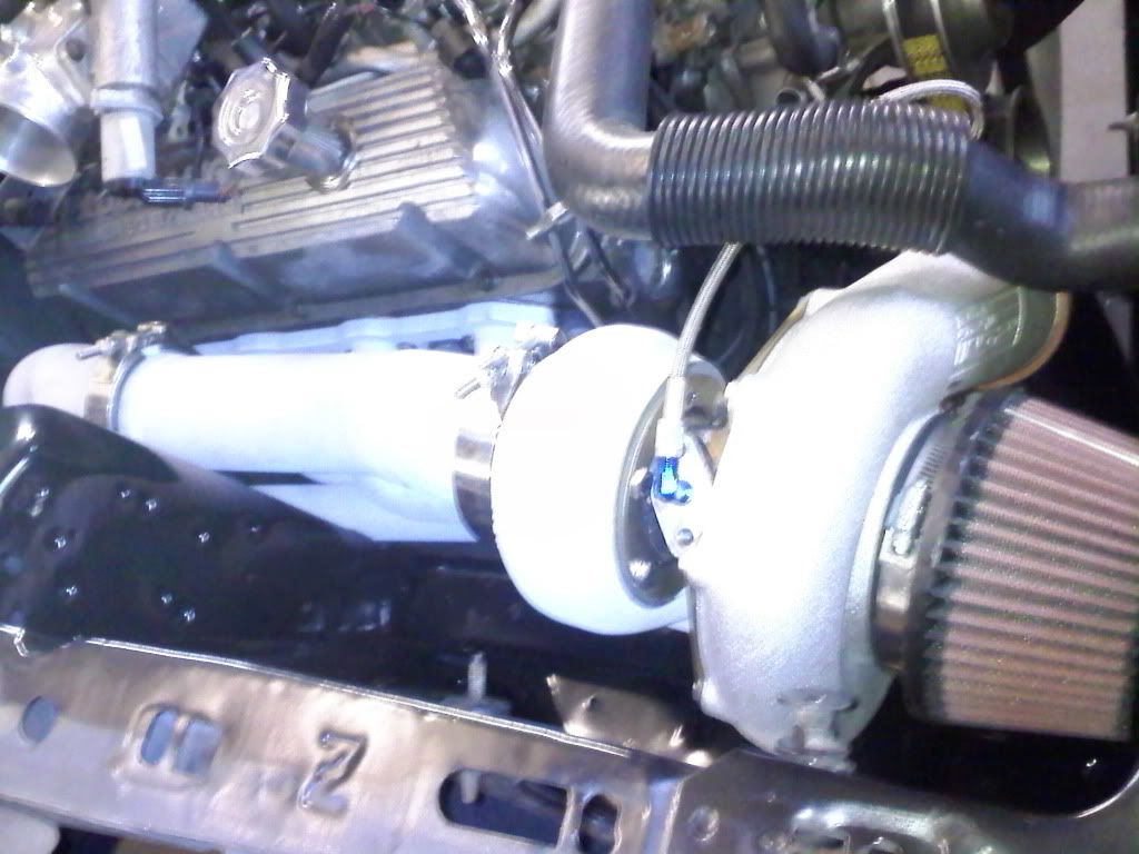

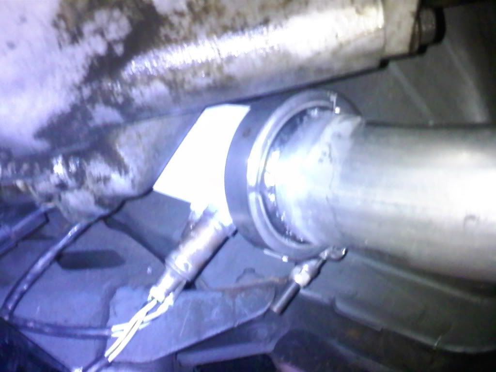

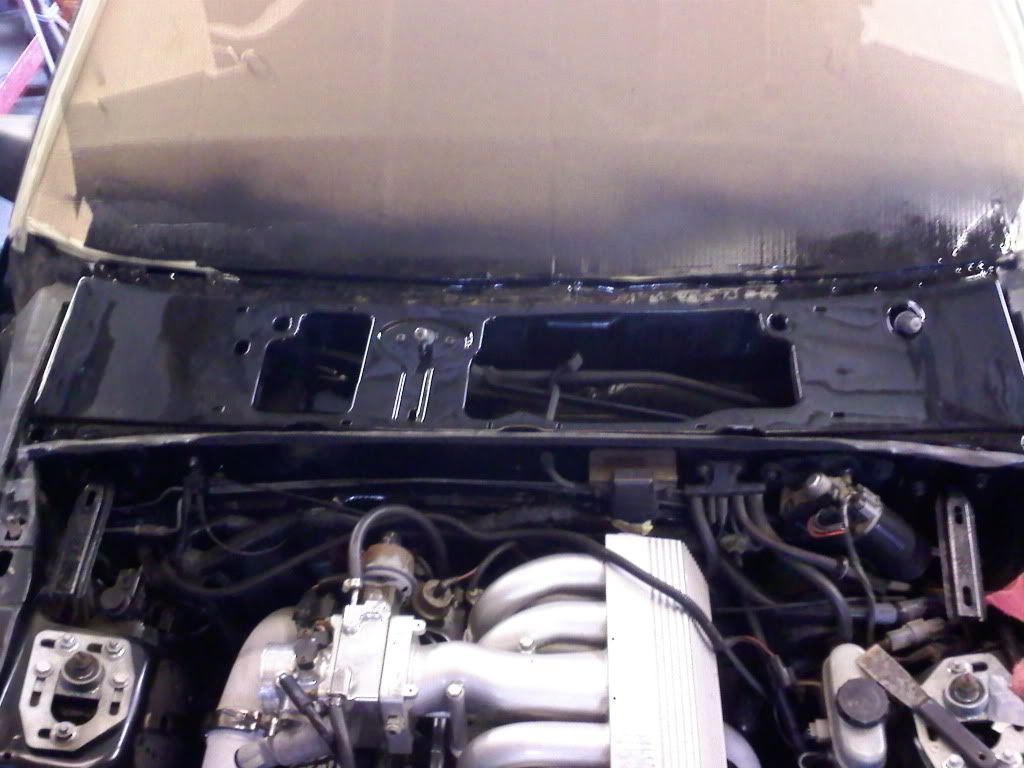

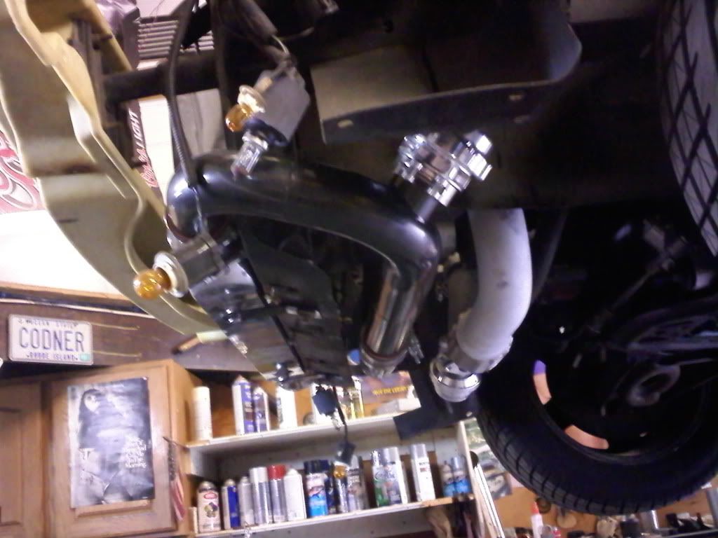

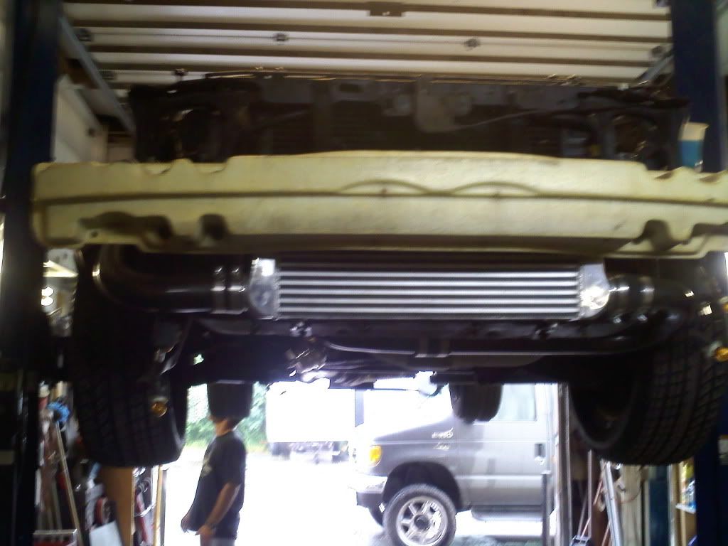

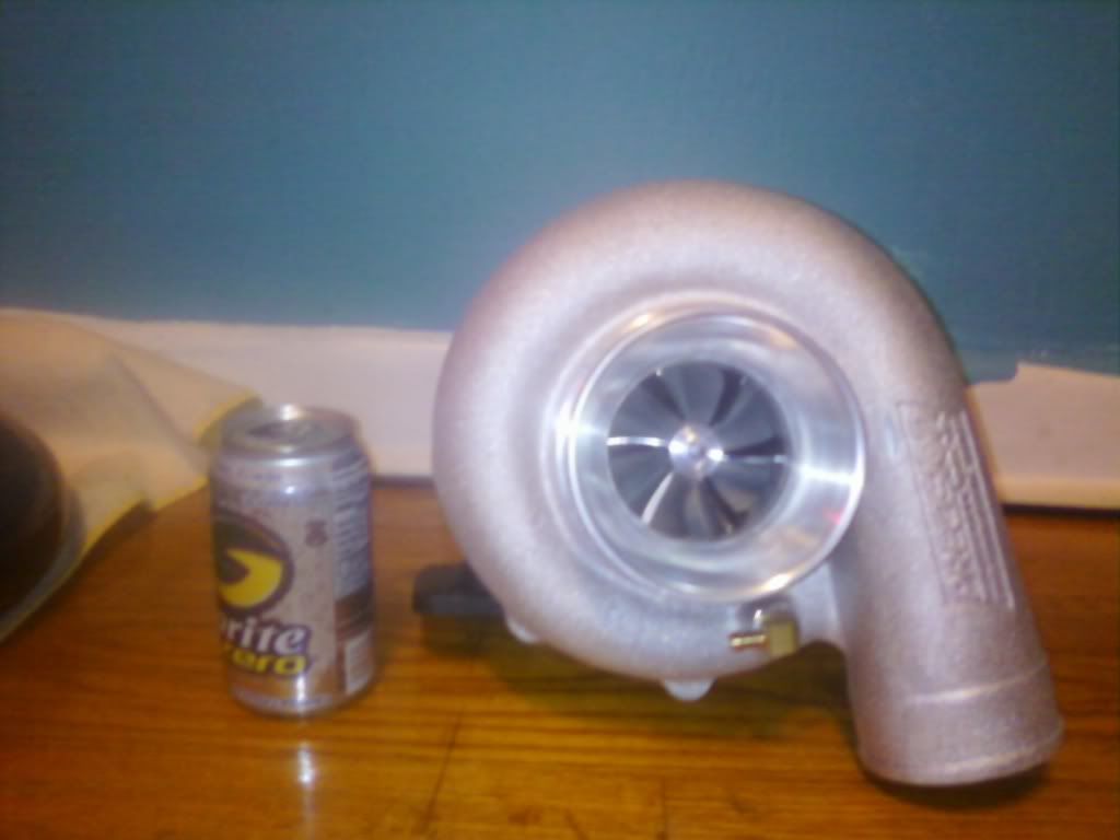

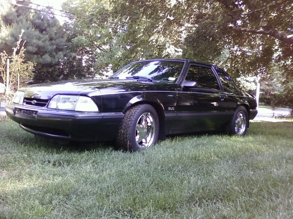

ok so here it is my car though out the whole deal.
quick list before pics
-motor is a gt40 crate with 16000 miles
-quicktime kit with turbo upgrade to 6776
-replaced windshield cowl ( bad safty latch hood blew up)
-relocated alt. to drivers side
- flaming river man. rack

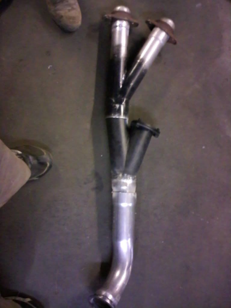

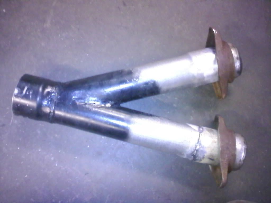

- self made y with jegs cutout to dual spintech 3 spins
lots of others please tell me what you think.
last summer before turbo was thought of
n/a made 276 rwhp and 299 rwtq
a long time coming but it came
then there was the mach up before the swane tech coating
final install
damn those o2 sensors are tight.
fixed cowl
pipes
front mount
flaming river rack

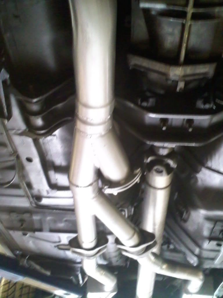

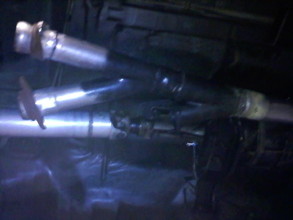

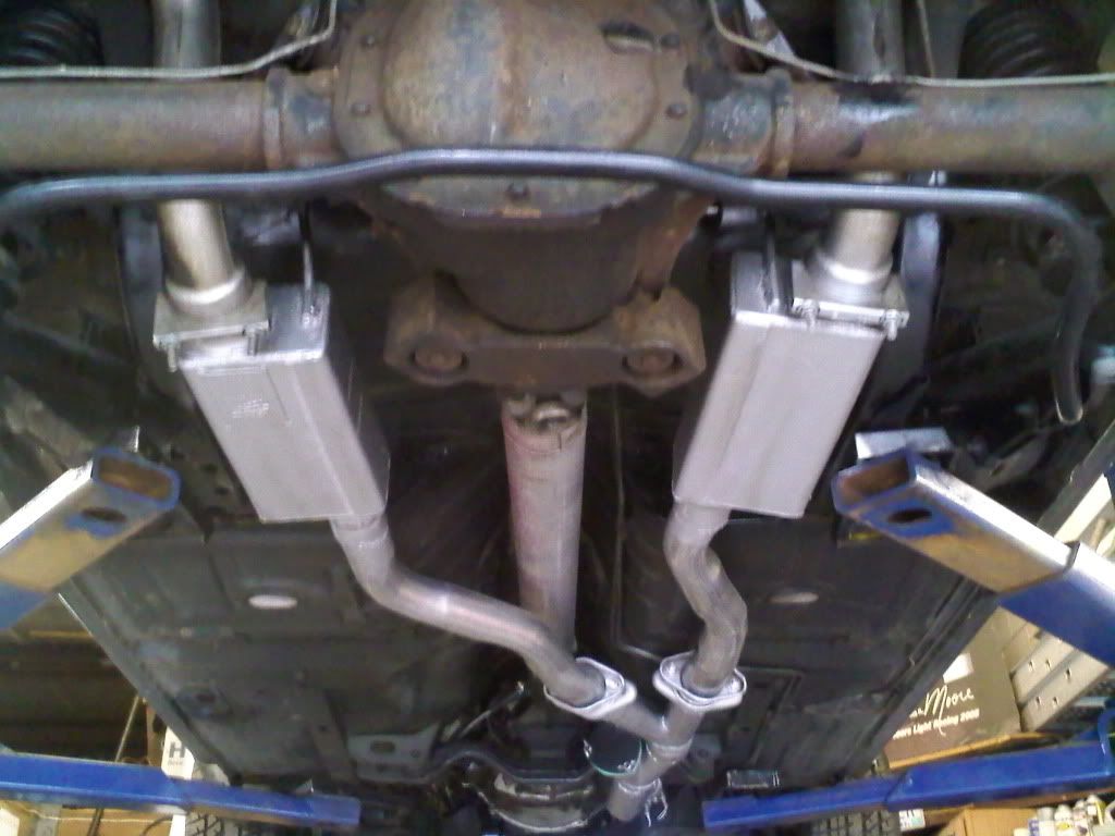

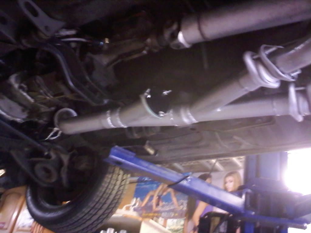

custom exhaust made via my own pipe bender
car is getting tuned sat so will have more pics /numbers for you guys

What coating is that you got there?

http://www.swaintech.com/store.asp?pid=10969
they were reffered by the guy tuning my car #### is awesome!!!

numbers are in
car before made 272 rwhp and 298 rwtq after the kit installed with and 8.7lb spring it made 433.8 rwhp and 459.6 rwtq
blackgt40notch is offline
Good numbers,
Probably crank it to 12psi and easily hit the 500rwhp club

it was boost creeping to 11lbs i am very happy with the #'s for now dont wanna split any thing in half lol
