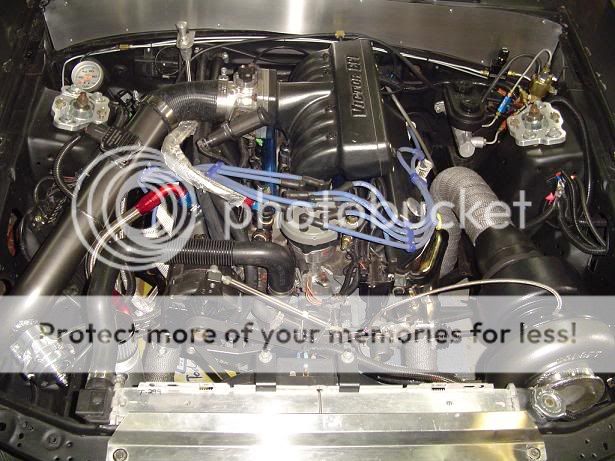

Holset HT60 on a 331, or in laymans terms a HUGE freaking diesel turbo on my stang...
This is a 331 SBF with a Holset ht-60 turbo off a n-14 cummins engine it came off a wrecked semi "Light roll-over". This was a 3 month build. The hot side and cold side was all fabricated in a 3-car garage. First test drive was today and it spools incredibly fast. 1-3 PSI in 2 seconds then instantly to 17 PSI. Time for a boost controller now because the motor is 10 to 1 compression ratio and I didn't really think it would spool so easily. Proof that a junkyard semi-truck turbo can work and build boost fast.
What do you guys think?

I am just wondering how long the stock block will hold

I can not take credit for the fab work, a good friend of mine did all the fab work because i don't have a welder. I plan on keeping the boost between 10-12psi because of the compression. It is being tuned with an Anderson PMS.

Originally Posted by STOCK 5.0 View Post
TProof that a junkyard semi-truck turbo can work and build boost fast.
who the heck said that?
my $80 holset makes 500rwhp with a stock 302 and ported e7s.
your setup looks great! What foot is the exhaust side? a t6 I am guessing.

The turbo has it's own flange, it is almost a T6, we just had to elongate the bolt holes a little bit.
ah yes . . . the "holset" flange. Mine wasn't quite a t4.
One last question, how in the world is the steering shaft run?

Stock steering shaft, in the factory location. The downpipe is an work of art.

The exhaust housing was ceramic coated black, all the hotside plumbing is just VHT header paint and header wrap.

What size down pipe?
That is a big turbo for a 60mm compressor wheel. haha Will a S400 or GT47 bolt right up to the kit as well?

People are always scared of the steering shaft. If your doing a custom kit there is actually more room on the drivers side. The motor is off set in the engine bay to the right a little. So if you plan well you can get a good size pipe on that side. I have a 5" down pipe that merges to dual 3.5" exhaust right after the steering shaft.
Every one said it was impossible. I guess they are stuck with a t4 turbo with a 3.5" down pipe. And no spark plug access with the dp on. haha

It is a 5in outlet on the exhaust housing, so we used a 5 to 3.5 reducer and 3.5 all the way back.
I am pretty much stuck with this turbo, because a Holset HT60 is a reverse rotation turbo compared to most.

Well if i had the choice i would build a 427 windsor with low compression pistons and get a HX60 (same turbo, but standard rotation) and run a twin setup.

Is the turbo mounted to the frame or are the headers holding all the weight?
If the former, do you have solid mounts to prevent the motor from flexing?
Yes the turbo is mounted directly to the frame because of the weight. And yes it has solid motor mounts...
STOCK 5.0 is offline
