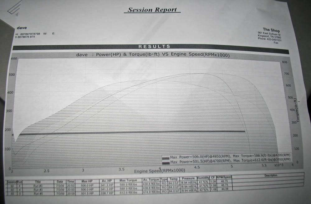

Shew, what a time I've had with the little problems with this car but I FINALLY got them all figured out. Here is the combo:
Stock bottom end
TFS heads
Stock Cam
1.72 Roller Rockers
Exploder Intake
70mm TB
Hellion Kit with a MP T70 .68 exhaust housing
#42 injectors
GSS340 intank pump
-Edit-
Pump gas
11.2 AFR up top
One issue I had was I'm getting some boost creep, the car creeps the entire pull to 13psi max. I made a 19* total timing pull and a 20* total timing pull, I've never noticed the car creeping before so I need to make sure it does it on the street and not only just the dyno. Anyways, with the car creeping to 13psi it's not getting the full benefit of "13psi" like it would if it spooled to 13psi and held it. So my question is, is 19/20* total timing too much for a car that's hitting 13psi right before the shift point(way past peak torque, so having timing up there shouldn't be as bad as if it was holding 13psi the entire time correct?)
Anyways:
19* total timing - 485hp/609
20* total timing - 506hp/612
Graph:

what was the problem? Im glad that you finally got it figured out!! if its not pinging, run the 20deg... if the air charge gets warm, my tune pulls some timing up top!

The cam was off a tooth.lol When I put it in I thought to myself, that thing looks a tooth off but thought I may of been worrying too much. I pulled the engine out to fix a few things(leaking oil pan gasket and weld fitting in the oil pan) and decided to pop the timing cover off just to be sure. What do you know, there it was, sitting one tooth off the entire time. Oh well, it was worth the time to pull the engine out because I'm making 500hp and have zero oil leaks etc.
Thanks for the assurance on the 20* tune, I may run the 19* tune around town and then switch it over to the 20* tune for the track just to be a little easier on it. Thanks again Bob!

simple mistake... im glad you figured it out without having to dump a ton more money.. Im glad that tune is working well for you!! Go tear up the streets now and let me know if there is anything else i can do for ya! My new shop opens on monday and im going to have a ton more products to offer!

Why are you sparking the charge so late?
Max cylinder pressure is about 16 deg more advance at 5k rpm.

Great numbers with the cam a tooth off and stock bottom end. Get a Dart/Boss block built for piece of mind and crank it up some more.
