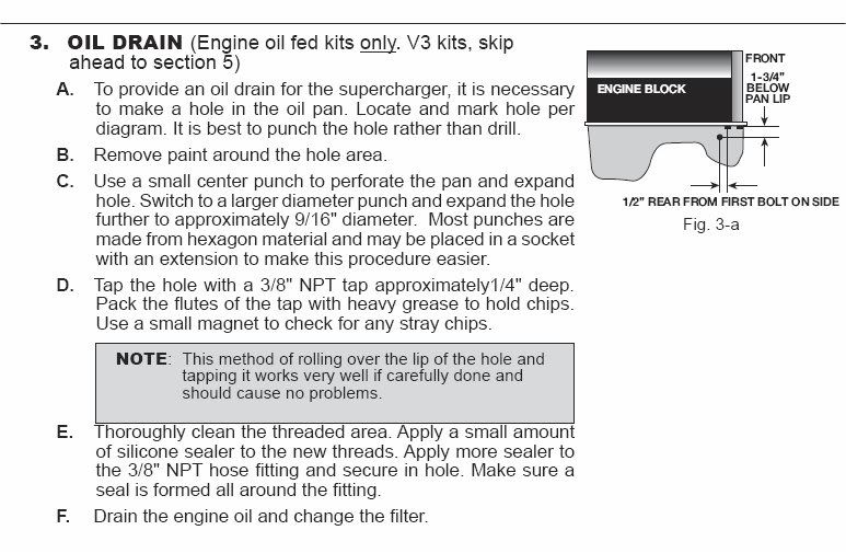

This is from VortechSuperchargers.com . This is the exact same way I tapped mine, and had no leaks at all; only difference is instead of sealer I put JB Cold Weld on the threads of the fitting and screwed it in. Let it cure and call it a day.
