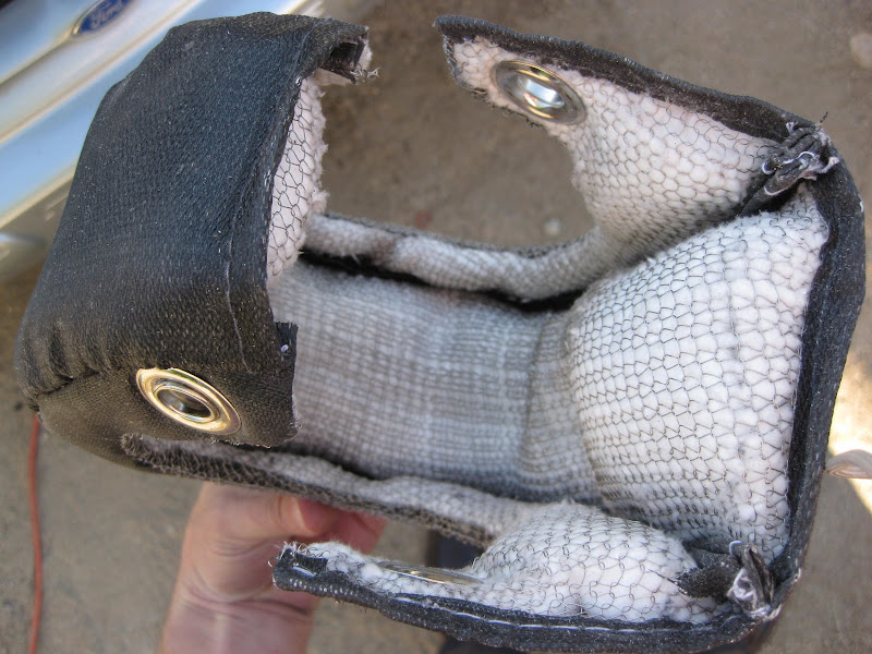

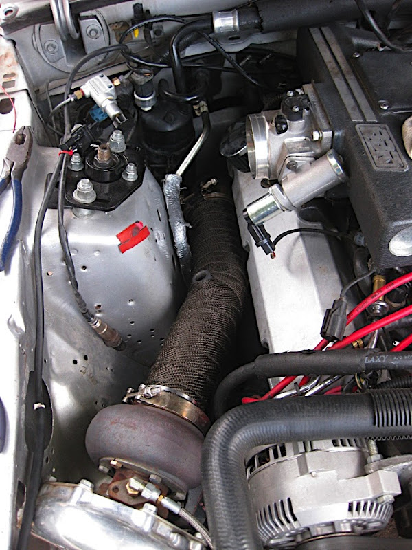

I wrapped my downpipe (it is ceramic coated as well) and then I put on one of those heat blankets they sell on ebay.

I ended up making this set after I torched the first lol. It worked out well because I was able to buy the MSD crimp tool (Link) You can see that I used some aircraft tubing in there as well just to be safe.
