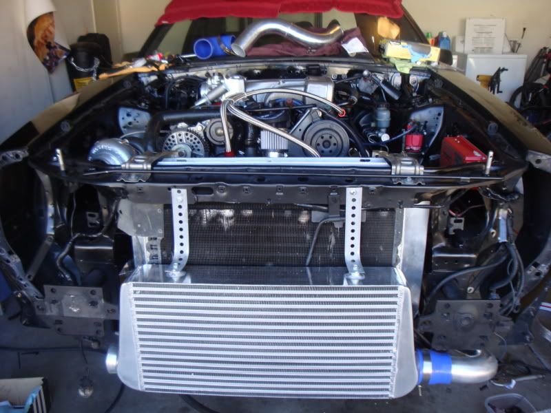

Got a lot done the last week, will be running this weekend for sure.
FMIC in place

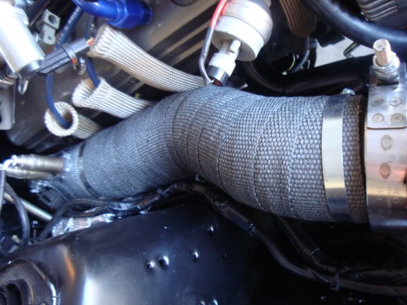

Downpipe wrapped go ready to go. 3.5" was a BITCH to fit in the car.

Looks good. BG kit? Fitting the 3.5" is the reason why I am having mine sectioned and V-Banded before it goes in.

looks nice............are you not running a cooling fan?

there's a small one in the pic, doesn't seem to move enough cfm...

no way that little fan will even come close to keeping the car cool
once you throw that intercooler in especially
I have the BG kit and everything worked pretty well, biggest complaint was their filter didnt even coem close to fitting.
And yea the 3.5" DP is a real pain in the ass

Another thing was my downpipe V-Band. That thing is bent to #### after putting it once, any ideas?

Because of the master power's flange, I had to take a grinder and grind off one side of the v-band's lip so that it would sit in there. Now it's no problem.

I got a KN, and yea you gotta grind the clamp.. its in the instructions
