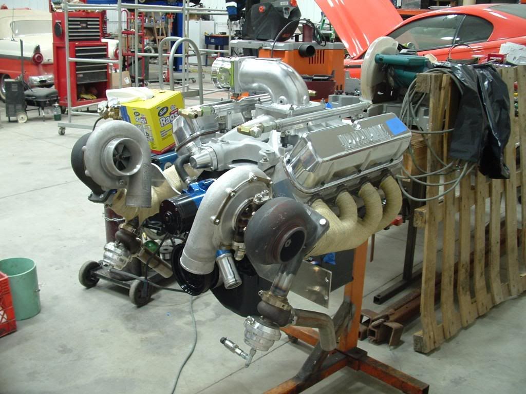

Originally Posted by dustang View Post
im going twins.. same turbos you have. with the correct combo lag is not really an issue. but when you pop the hood open, people really go nutz over twins. LOL
Inexplicably….people go goo-goo ga-ga over twins.
It’s only margianly more expensive...and actually quite comparable if you can source turbo’s with internal wastegates. The cold side tubing can be a bit more complex, but you always have the options of simply going with a 2-in/1-out intercooler instead of merging the 2 together (mine merge together before the intercooler). The exhaust however is FAR more simple….especially if using an internal gated setup, as you have no cross-over or flex pipes to worry about.

Piping difficulties aside...singles are just as complex as twins. It's just that the singles' mass of excess piping is on the hot side instead of the cold side like with twins. In fact there are quite a few single kits that have MORE piping than a twin setup.
Twins are more versatile on a street car IMO. Plus the efficiency factor is on your side. Two small turbo's will spool just as effectively as one large one. The difference is, you can change A/R housings on the smaller turbo's if they're too laggy, that will have a lesser effect then swapping an A/R on a big single. So don't base your decision on spool time or you will be chasing your tail.
But FWIW, turbo's are turbo's. They both do the same thing. They both produce boost, and there is no right or wrong way to go. A bigger single will get it done just as well as small/medium twins. Find a kit you like that fits your budget and bling factor and run with it. Either way you go, your passengers are going to sh*t themselves.
