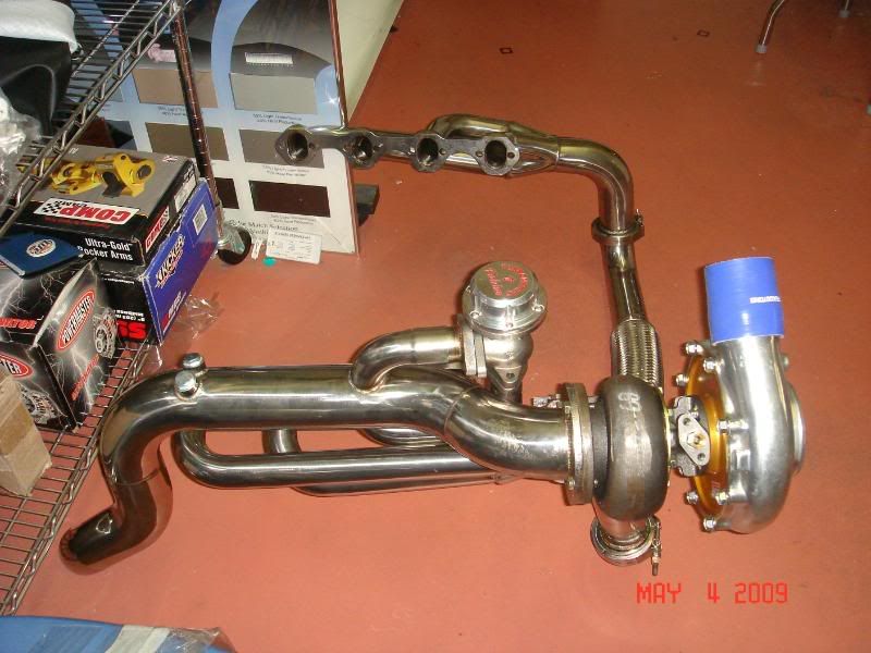

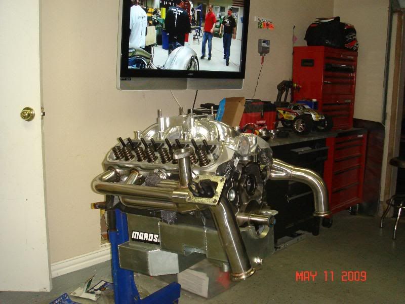

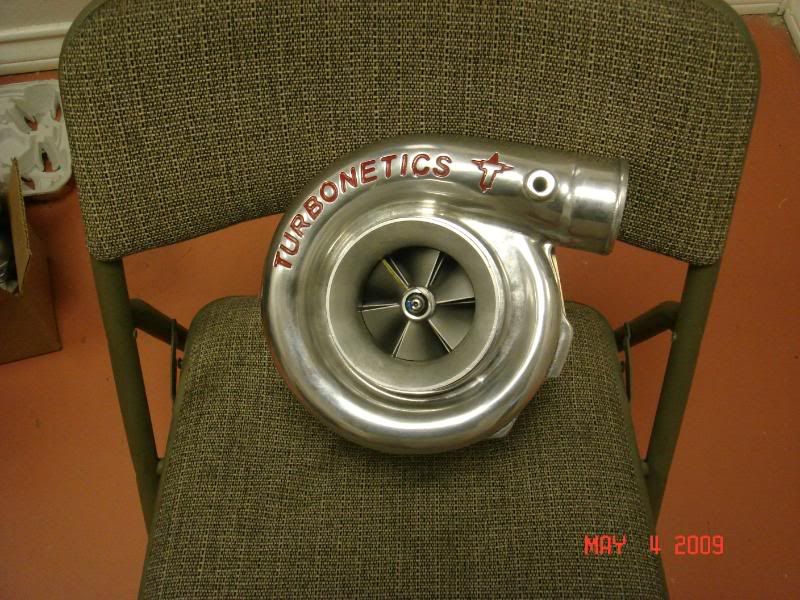

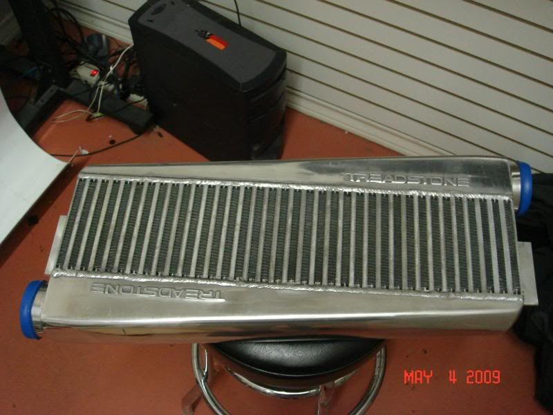

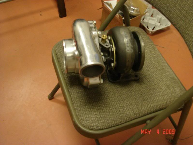

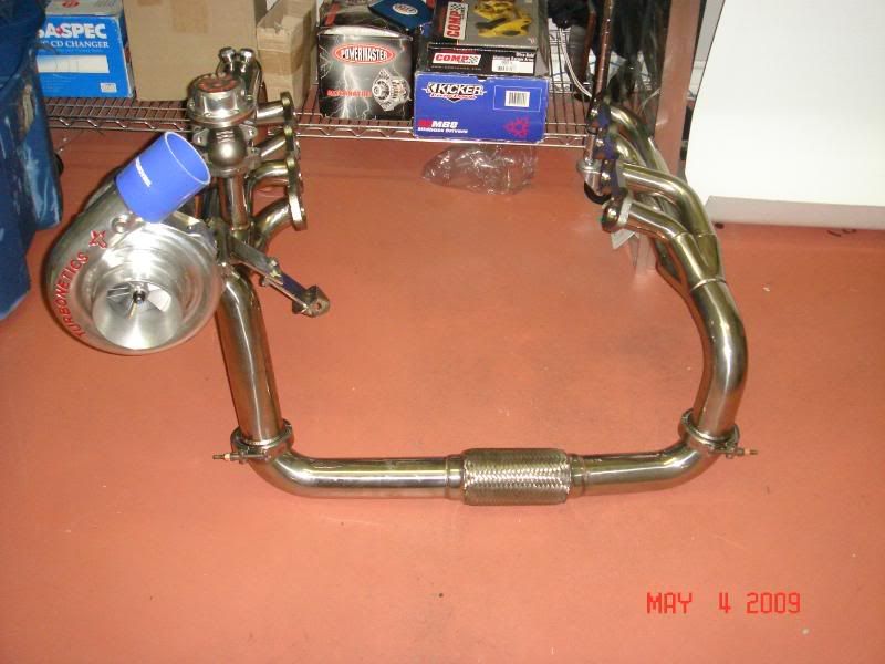

took some pics of the turbo kit during lunch we had so much work i did not have any time to work on my car today maybe tomorrow......

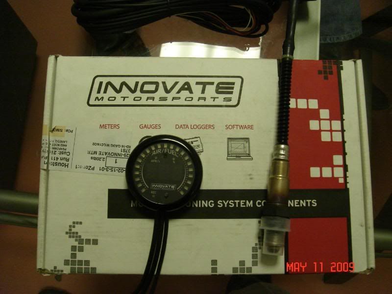

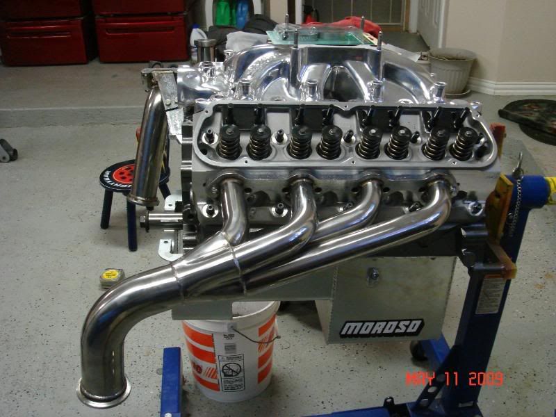

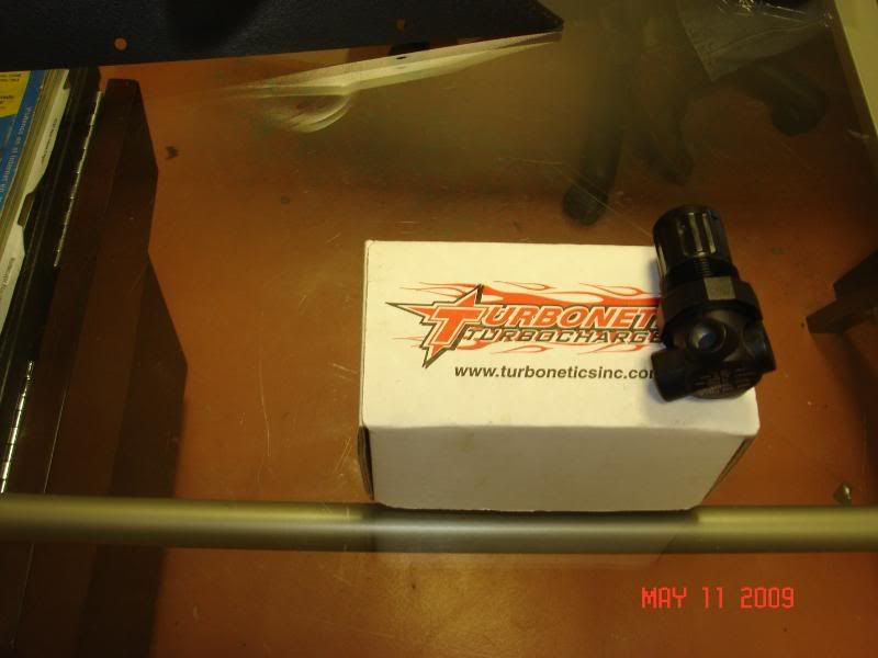

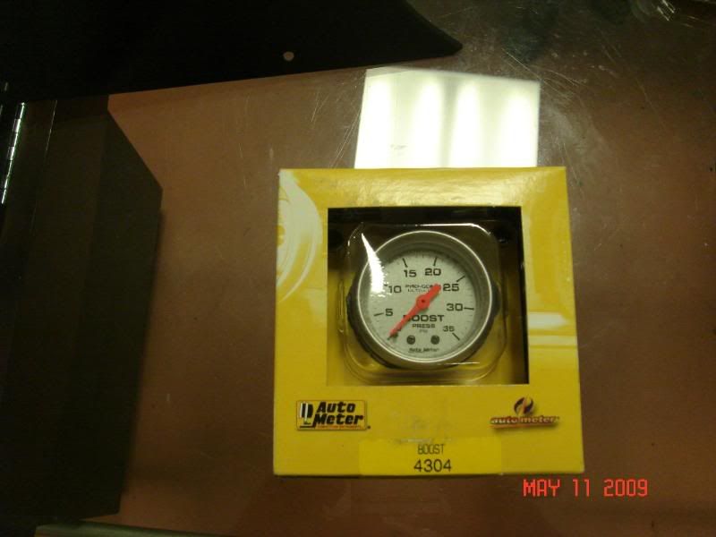

well still have not had time to work on my car but tomorrow i'm taking the day off to work on it ....the good thing is that i got alot of parts in and i just finished heat wraping the headers.....
turbonetics bov
boost guage
boost controler
60lb injectors and pms maf
innovate wideband

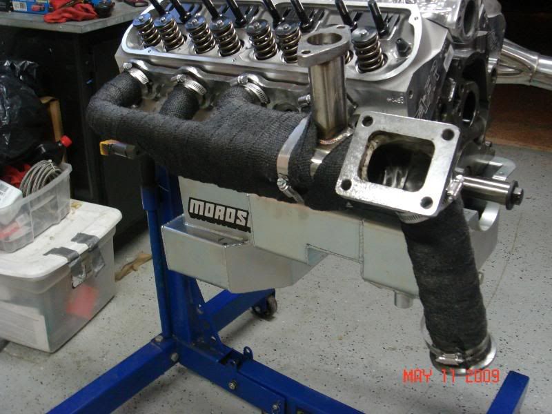

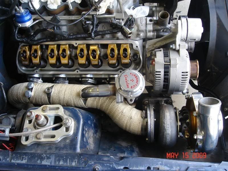

dont kill the messenger. but a local guy has had bad luck with that thinwall stainless and there is a thread on turbomustangs where Brian from BG (treadstone copied his kit) stated he didnt use stainless for that exact reason.

yes i know its not a great turbo kit but its just for mean while,once i put in my 331 stroker i'm getting a new kit 88mm turbo,this kit is only to play around with....

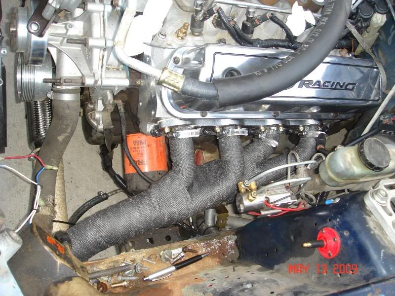

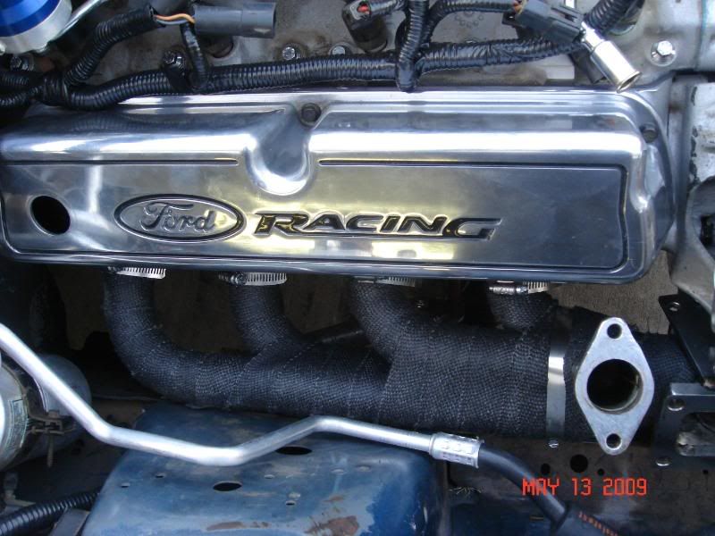

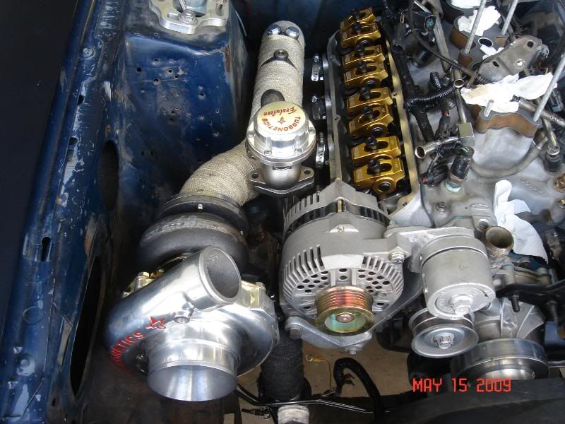

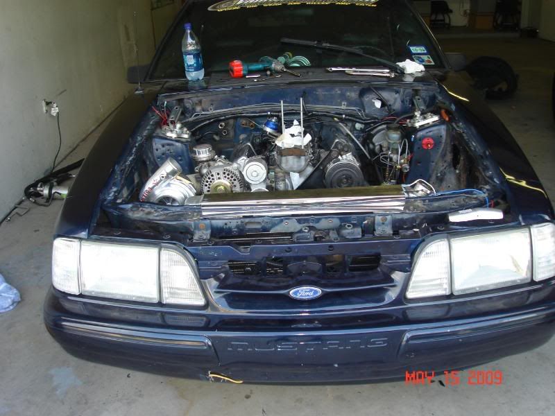

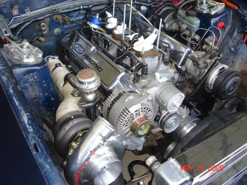

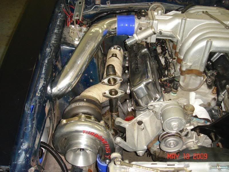

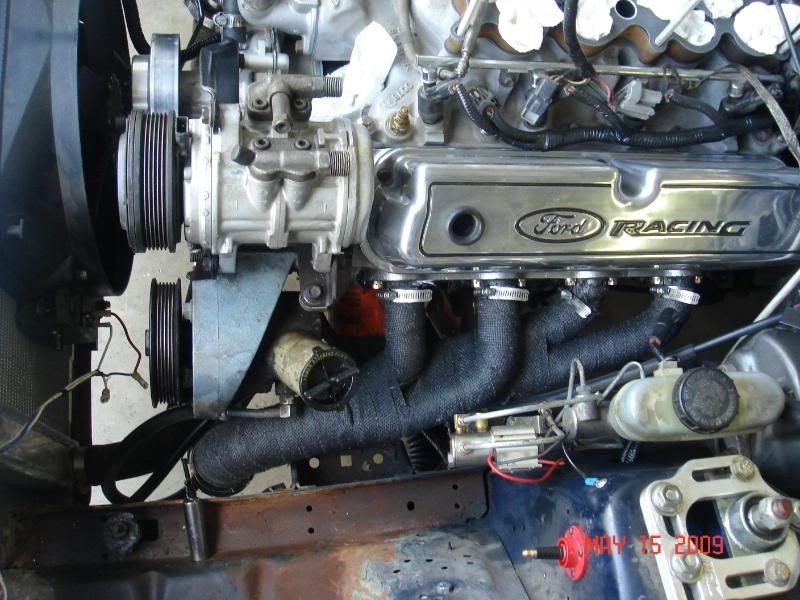

got my hot side on yesterday hopefully get some more stuff done today and on the weekend,does anyone know if i can keep my a/c working or do i need to get rid of it.......

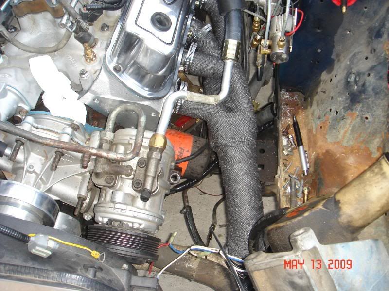

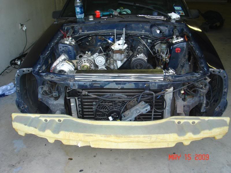

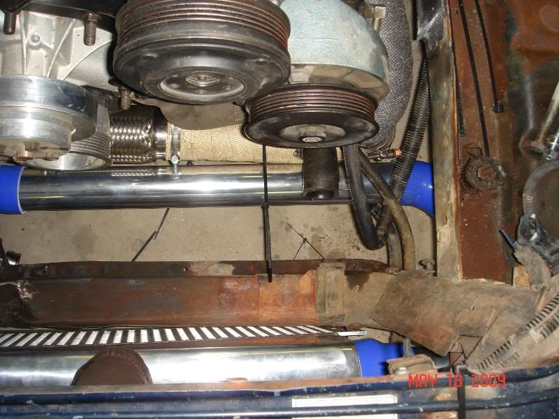

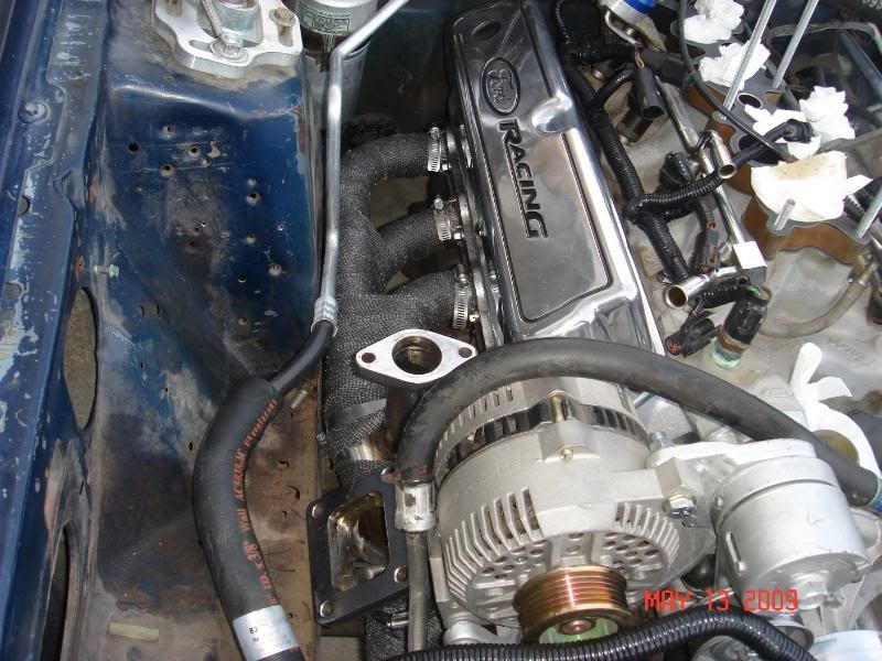

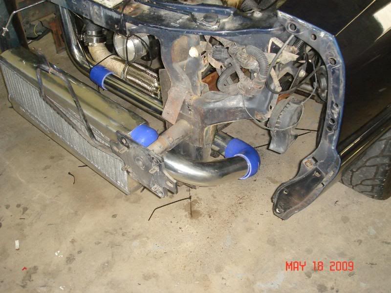

i kept my ac with my B&g kit so you will be fine as well. that line though will be right under the turbo which will def have a lot of heat on it. you may want to try to bend it out of the way or have a custom line made

What kind of shop would I get to make me a custom hose.

A hydraulic hose place should be able to help you. My buddy had a local place custom bend one AC line on his Novi '93 Cobra set-up. Didn't cost too much either.

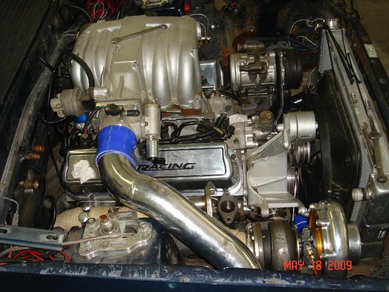

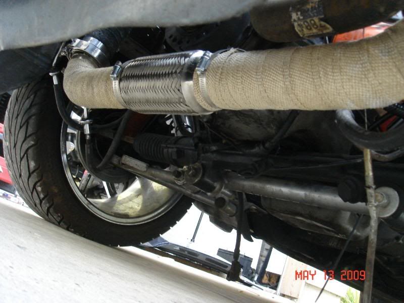

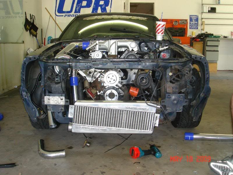

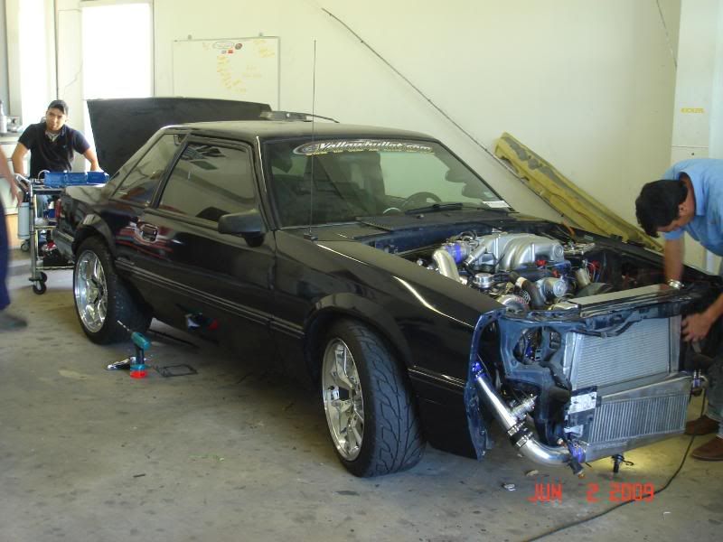

got a little more done to the install,got the down pipe in had a little fun doing that but it finally went in,took the front mask off to mount the intercooler....

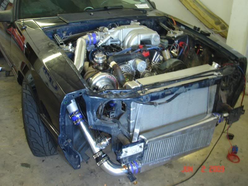

post #18 of 43 Old 05-18-2009, 10:52 PM Thread Starter

Your gonna have to ditch those 3.73 gears they dont help your turbo spool!

Yes do not run rampaging with this combo because the stainless and the gauge cannot take the heat especially since you wrapped them. Trust me what Bryan at B&G said makes sense from an engineering and thermodynamics/heat transfer standpoint. Puting the thermal barrier there will only heat up the tubes more (which I know is the point for more power and to keep moisture out and stop rust) but just be careful.
Oh and yes 3.73 = bad for turboes. Unless you are planning on a really low numerical (custom) geared tranny... not sure why but thought I should cover my bases. Good luck I meant no bad Joo Joo.

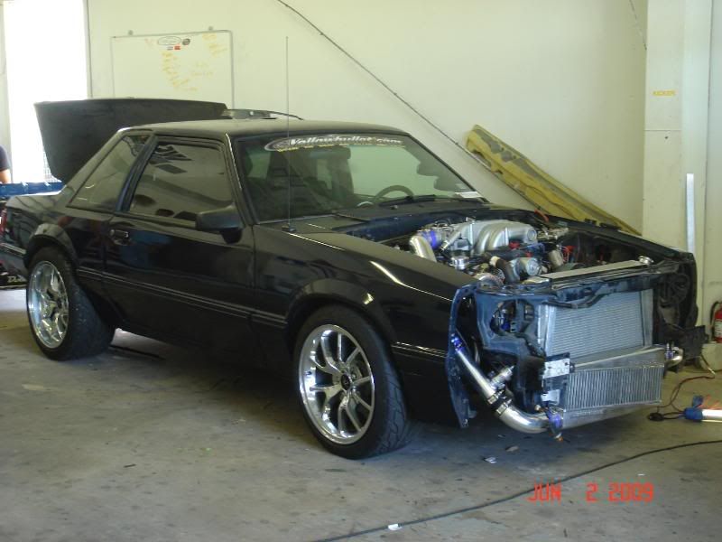

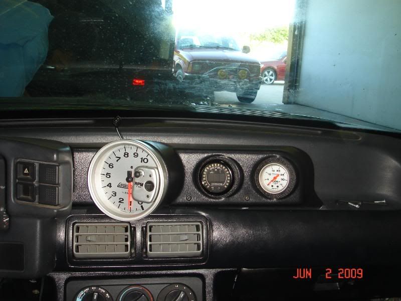

finish installing the innovate A/F guage,boost guage and the tach on the dash pod,turned it on to adjust the timing ,took of the nitrous,wired the eletric fan for the radiator,should be ready for tuning next week..........

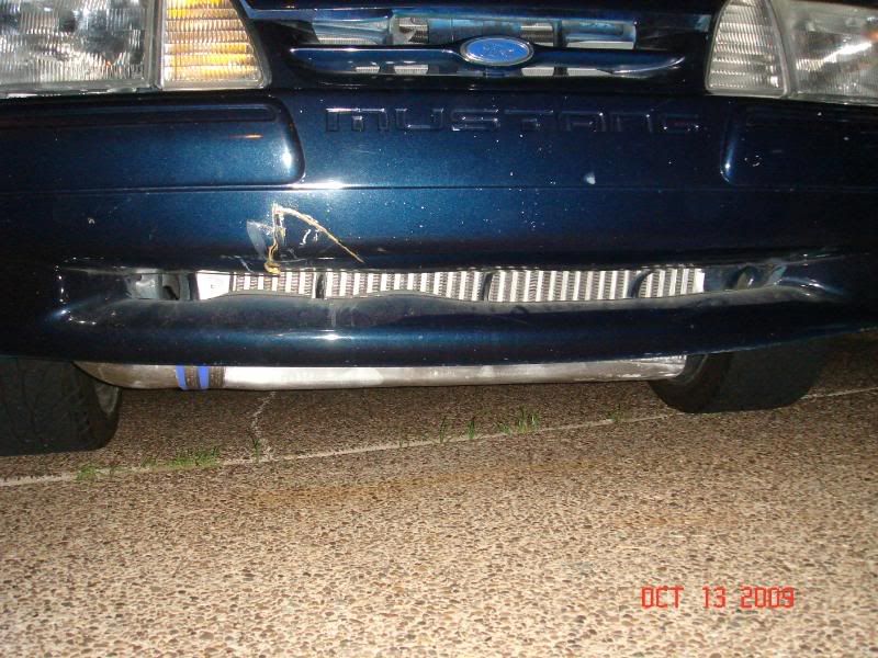

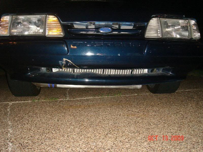

i've been driving the car around but have'nt gotten it tuned yet,what do you guys think about changing out my cobra intake for the victor jr spider intake before getting it tuned,its stock short block,edelbrock heads with the 2.02 valves,tfs stage 1 cam,60lb injecters,72 mm turbo,will it help or hurt it?
this is the intake.....

I know a guy that has one and he said it killed his bottom end power. Since this is just a mean while, I would prolly leave the sypder for the 331 with the 88.

you got pix of the car with the front bumper back on? I am going to be using the same I/C just wanted to see how it looks with the bumper on.

no i dont but i'll take some tonight or in the morning and post them.....

Posts: 153
We ran that kit and had no custom a/c lines made, just take your time and bend the lines to fit. When i did mine the a/c charged up and never had a problem. Put about 15k on it that way.
john

Posts: 224
sorry i took so long,here they are......
89 lx stock short block,cam,heads,intake,procharged 11lb boost,t-5,UPR k member,UPR adj upper and lower control arms, 10.95 ET...
88 lx stock short block,tfs 1 cam,cobra intake,edelbrock performer heads,72mm turbo,3.73 gears,UPR k member,UPR upper and lower adj control arms...
cam69 is offline
