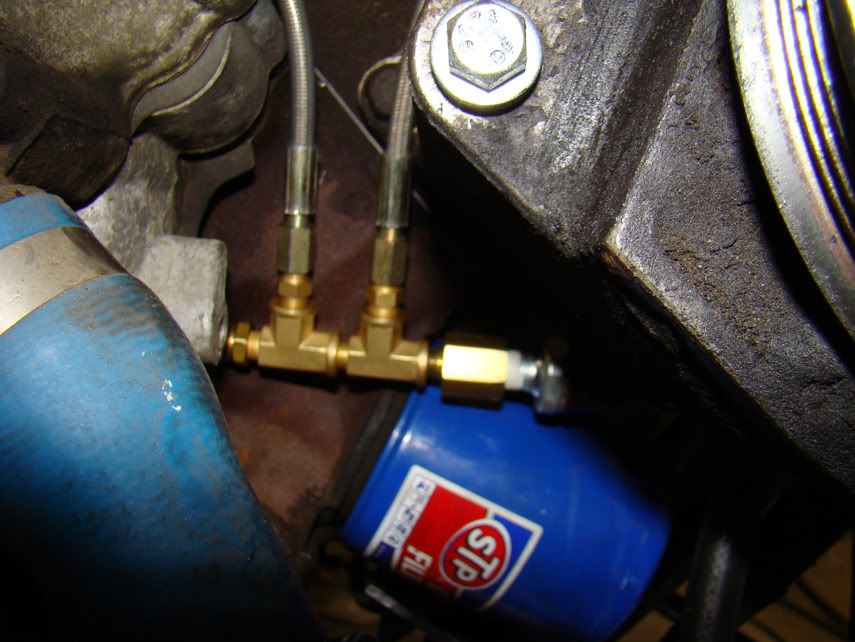

how are you guys feeding the oil supply and running an oil pressure gauge. running a tees seem like alot of cluster. what size line should i use to each turbo? running t3s thanks

Here is what I did.... (-4an feed lines along with .060 restrictors)

I used brake lines for feed. Then -10AN drain lines. More degenerate but it also works.

Here's what I did...

thanks for the pics, have given me some new ideas. do you guys running any extra oil then what the pan calls for sorry if its a stupid question 1st kit i building on my own.

I don't...and really, there is very little oil volume in the lines that feed the turbo's.
