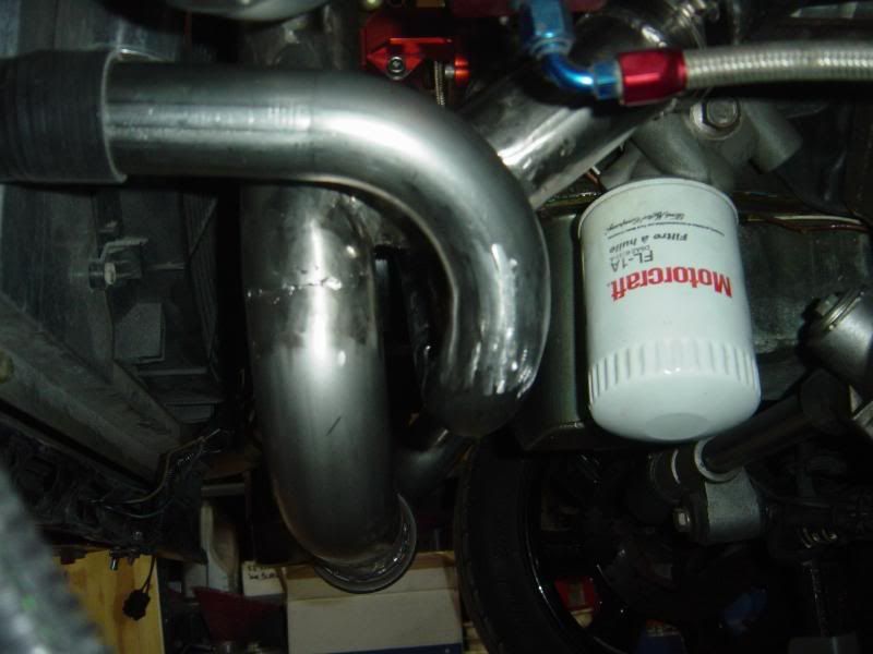

do what i did, just make one out if tubing.
upper
Lower

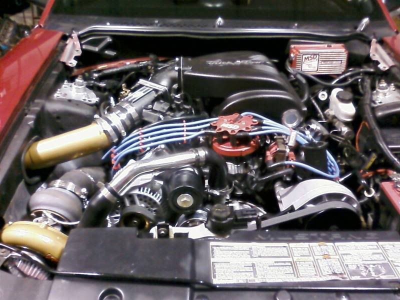

heres mine...i used the vortech pipe
TURBO'D NCR 302 G.R.E.A.D. TUNED
