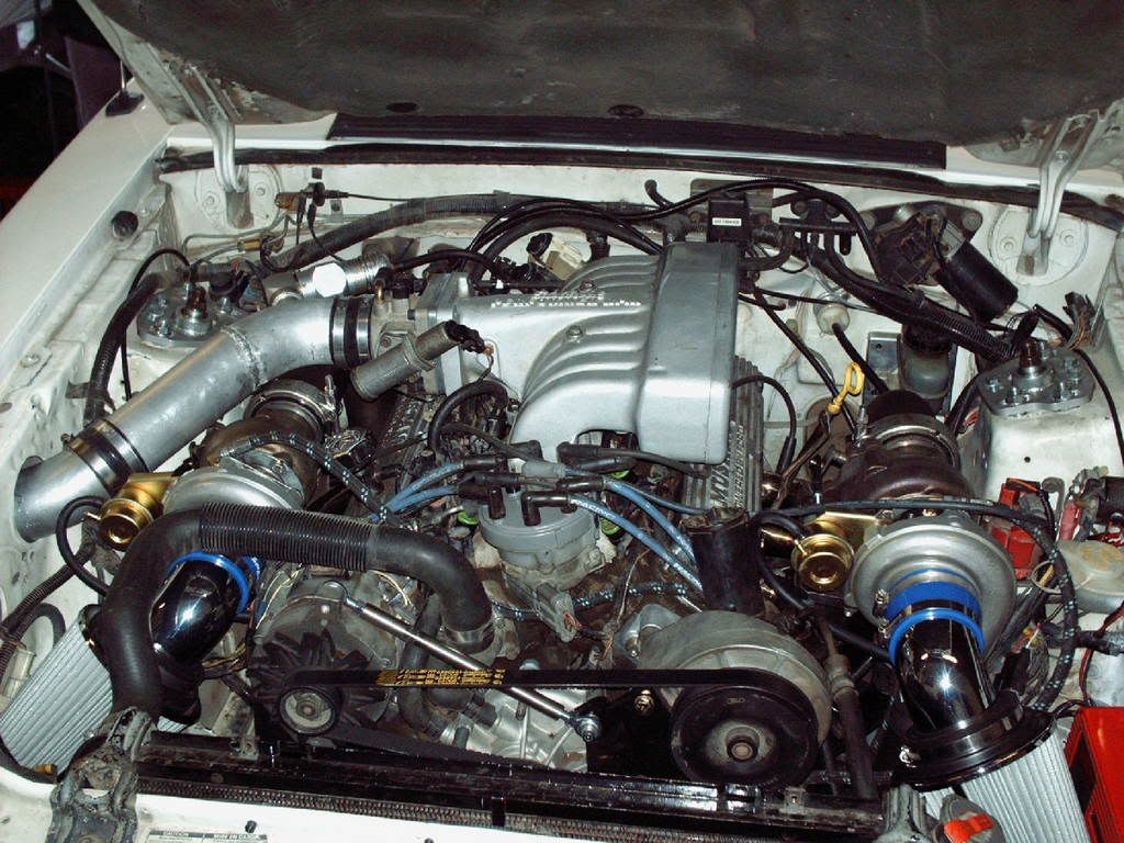

Here is a pic of the old setup.. Twin turbo ebay headers... 3" down pipes.. Manual brakes, etc.
We ditched the ebay headers because of multiple reasons.. (manual brakes, snapping bolts cuz of the strain from the down pipes..) and we were having tuning issues.. come to find out I had a big hole in my intake manifold from someone trying to port it.. I have no idea how long that holes been there either..

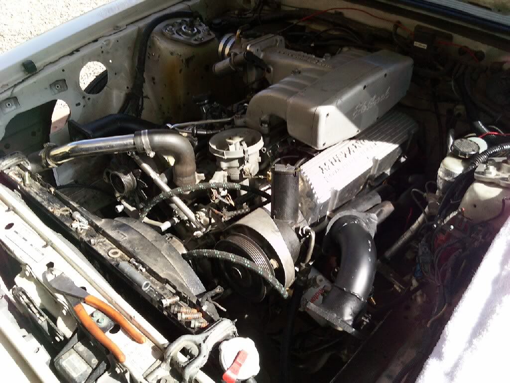

Here is a pic of the intake manifold back on as well as the charge pipe.

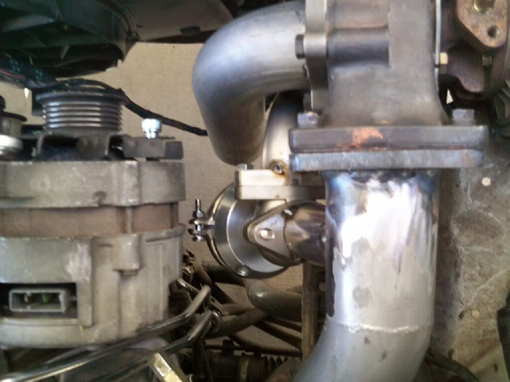

Here are a couple pics of the wastegates positioned and tacked in place for the time being! I'm stoked!
Here is the passenger side wastegate..
and the driver's side..
They're both dumped into the atmosphere.. I'm not sure how it'll sound.. I'm sure it'll sound pretty cool though..

The new project is looking good. Congrats. Did you have a thread for the EBay build over on the turboforums? Is your car a daily driver? I haven't really minded the manual brakes. They take a bit more muscle, but the car stops just fine.
Also, is the first pic how you ran the car? The wastegate actuators have the boost source on the wrong port.

Thanks! Yeah I did have an ebay thread on the turbo forums.. I haven't looked at that thread in a while.. I figured I'd start a new one since we changed the setup. at one point it was a daily driver.. I've got a cavalier for the daily grind haha. I'm sure though I'll be driving this car a lot.. I never intended for it to just sit and collect dust, it just ended up that way lol.
You know I don't think I really minded the manual brakes much either.. but given the choice I'd much rather have power assisted everything.
and yeah that's how it was ran.. but they were on the right port.. if you put the boost source on the top nipple it would've held the gate shut.. and with it on the bottom it allowed the gate to open when it hit a certain amount of boost, as far as I know.. atleast that's what made sense to me. haha

the waste gate flanges have been tigged up. I'll have more pics by the end of this week
