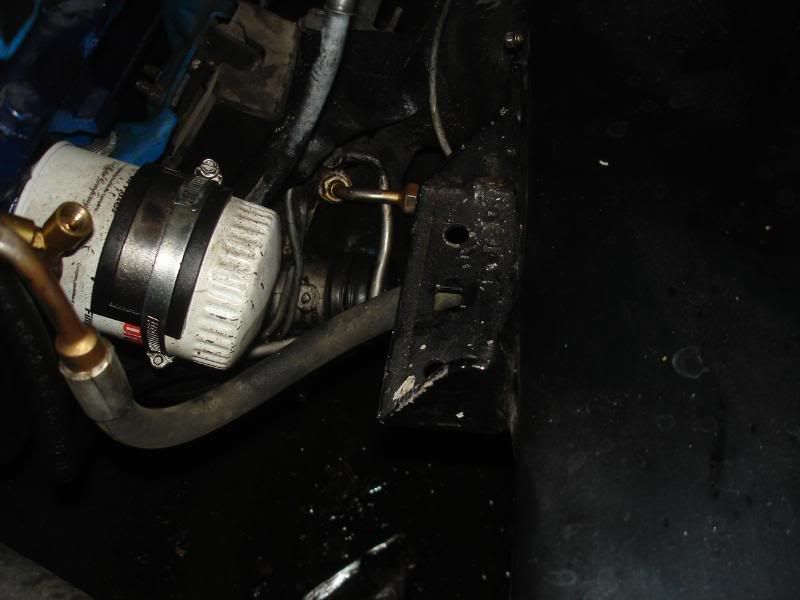

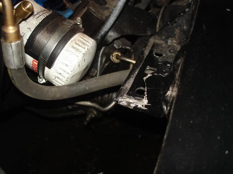

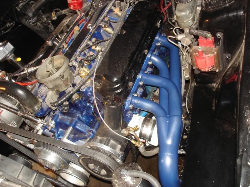

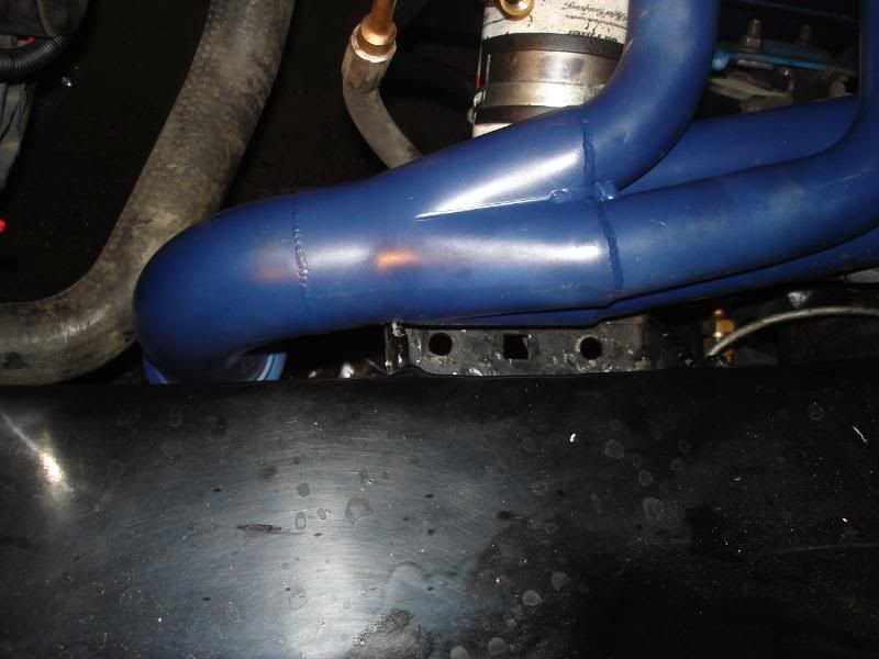

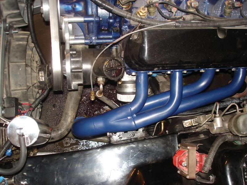

well, you asked for pics...
Turbomustang
Mesarina is offline

thats abotu how much I had to do on mine also

Mine rests right on the sway bar mount. Had to finesse it in but fits great.

That is a big chunk. I do see stock motor mounts in there so it may make sense to make sure you have newer polyurethane mounts. Older ones are known to collapse as the rubber deteriorates. In adddition, it is a bit risky to use old mounts with high horsepower.
I have a TFS highport specific kit which could be some part of the difference but it doesn't even come close to the sway bar mount.
I had a minor clearance issue on the passenger side waste gate that I addressed with a bit of grinding on the frame rail. I'm not sure my setup was "typical" since it has two 38 MM WG.

Wow, I have stock motor mounts and no cutting necessary...glad I didn't have that problem

I really appreciate the responses and pictures! So the general consensus is that with newer poly mounts I should be ok with maybe some slight grinding? I know my mounts are probably shot, I think they are stock and my bbk lt's are rubbing on the steering linkage slightly, so I will be getting a new set shortly anyways.
