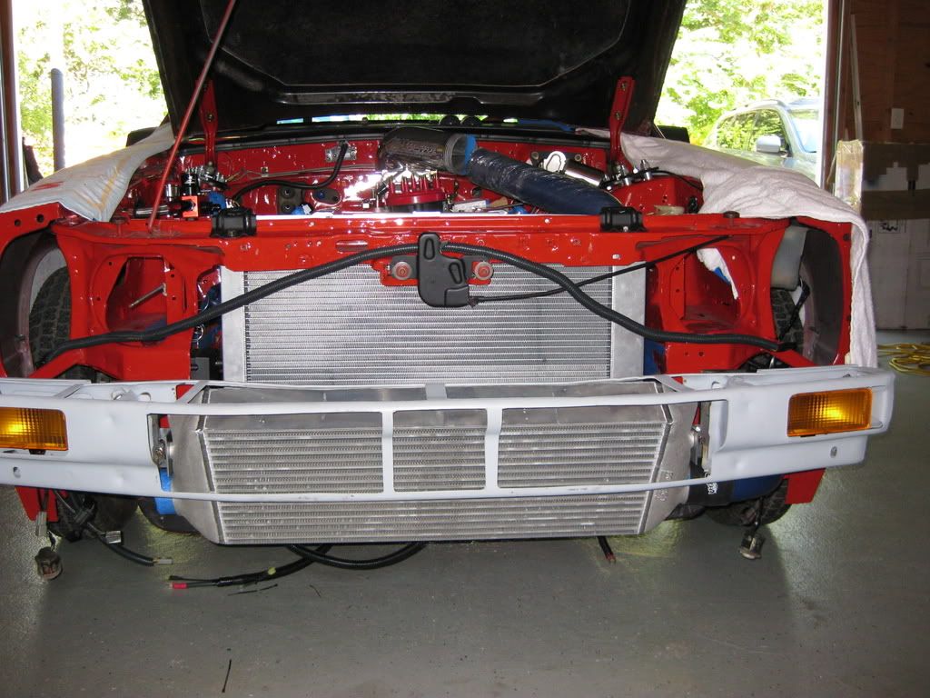

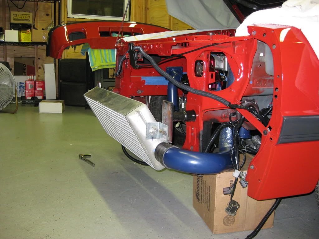

I just got my 31x12x3 intercooler mounted in yesterday, I'm fabing up an intercooler to a Kenne Bell on a fox body mustang here is a link to my project. Mine starts on page 4 post #123 https://forums.corral.net/forums/show...=648301&page=4

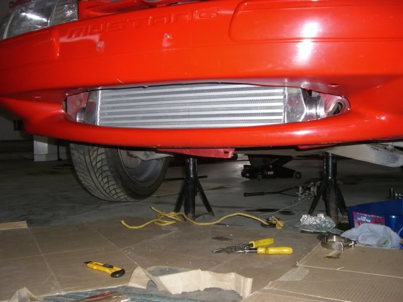

Here are some pics of my intercooler installed had to trim the front cover mouth ends only as I took out A/C.
