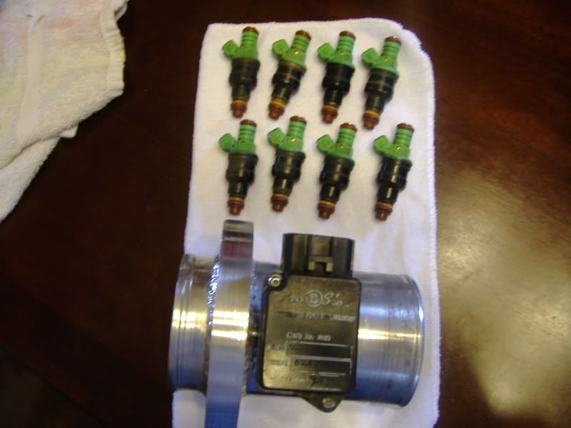

Sweet, thanks for the pics and replies....I'm most likely going with a pmas 3 incher....Keep them comments coming though

heres the setup i have with my quicktime kit...pretty nice 360 pro-m for 42's
TURBO'D NCR 302 G.R.E.A.D. TUNED

98GTfromGA's Avatar
Join Date: May 2001
Location: Houston
Posts: 1,203
3" Pro-M protube for 60lb injectors
