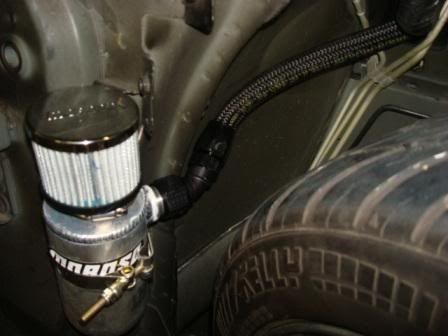

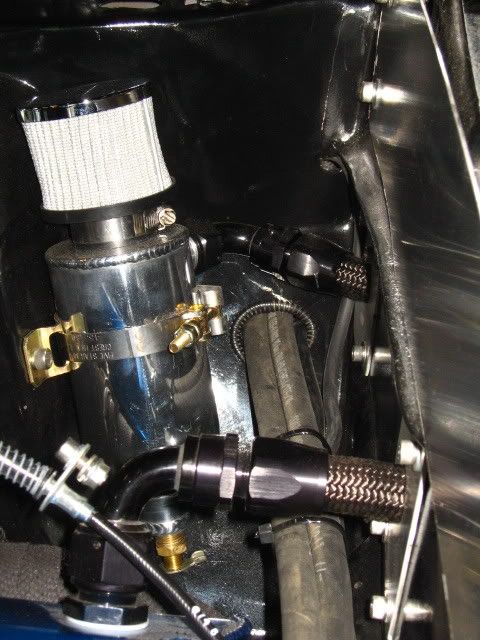

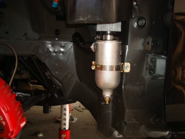

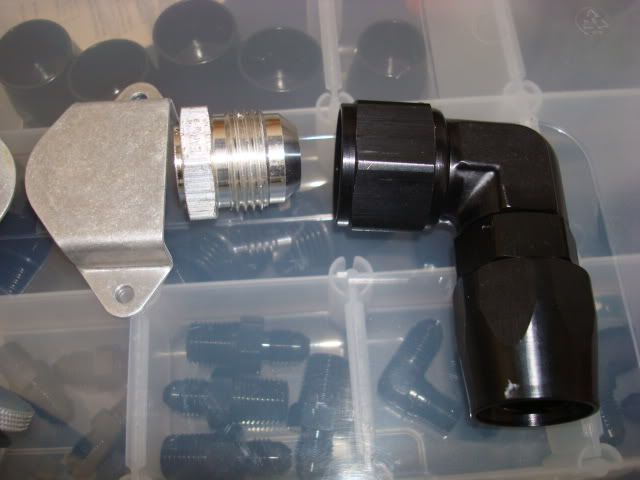

I used -12an also. I welded two -12an bungs to the rear of each valve cover and tacked in a Moroso oil deflector underneath. Each side has it's own breather catch can in the wheel well. When the turbo kit gets installed the end of this month I have a GM electric evap pump that we are going to plumb into the pass side between the catch can and the valve cover. the pump is going to come on at 3lbs of boost, Racetronix sells a complete wiring kit with hobbs switch. All it needs is key'd 12v, ground and vac/boost source to mount the Hobbs.

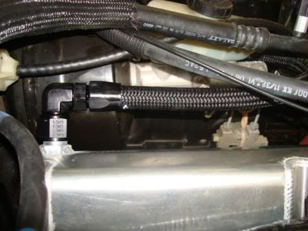

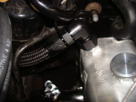

pass side, (steeda screw in fill cap welded in)
pass side breather catch can
drivers side
drivers sde breather catch can
baffle, bung and Earls ano-tuff 90* swivel hose end
