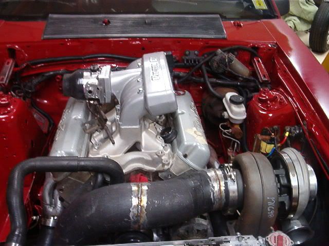

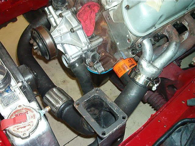

Hey guys, i just got my car running this weekend and am having trouble with the car getting hot and staying there. I know alot of you all have T6 setups with the crossover and downpipe very tight to the radiator hoses and water pump as is mine. My crossover is wrapped but havent wrapped the DP yet. What kind of temps are you seeing? Before w/ the BG CUSTOM TURBO kit and the 302, i never had a problem. Ran the same fan and radiator that im still using. Main diff is all the exhaust and a much bigger intercooler than i had previously.
i have a AFCO radiator, 160* Tstat, w/ 14 or 16" fan (cant remember) that I have on a switch, running straight water, standard rotation standard volume water pump. I ran the fan the whole time today and still got hot. I dont have a water temp gauge :doh: just the stocky and it got up to the "o" in NORMAL which i assume is pretty damn hot. Intercooler is a 31x12x4 which i know alot of setups on here are running. I ran the car with the cap off and waited to the tstat opened and water was flowing through the radiator and topped it off so i assume there arent any air pockets. Ive got this posted on TTF.com too.
Any suggestions??

wrap EVERYTHING !! get a turbo blanket and a real gauge. The stocker is junk but "o" is DEF too hot lol
does it do it while driving or only at idle?? IF driving helps then your fan isnt enough.

it starts while sitting at a light or a stop sign waiting on traffic. But once i get to moving, the temps arent coming down, they will actually start to creep up a little. Im gonna wrap the dp today and possibly wrap the radiator hoses too unless thats a bad thing lol
im gonna pm the guy on here with the ram, taurus, and MKVIII fans and see if one of them may fit b/w the rad and the dp

It wouldn't be a bad idea to wrap the radiator hoses as well as the DP. They sell a heat reflective tape at Summit. I've used it on several things in my engine bay on its own, and in conjunction with other types of heat protection.

That turbo hotside is HUGE.
No #### its gonna be hot lol
You need to wrap it or do something, that #### looks insanely unsafe on the street.

Yes get rid of that fan and get a real fan. The Taurus or Mark VIII would help a lot. You might run warm still will al that exhaust piping in the engine compartment.

well, tried to drive it around some more today and it just aint gonna work. Im gonna order a bigger fan and wrap everything. I still wonder though if there is an underlying problem with my water pump or thermostat but not likely. It does give off a LOT of heat.
Turbo is definately big. Im curious as to what exactly you think is unsafe about it?

A massive turbo on the street with who knows how much torque, is unsafe, yet, fun.

You should hide the selenoid wires in the fender.....dont you think?
That turbo looks like it could cook a turkey in 30 minutes let alone those wires!

its not nearly as close as it looks
