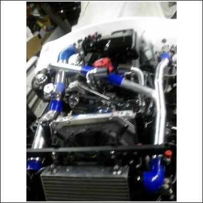

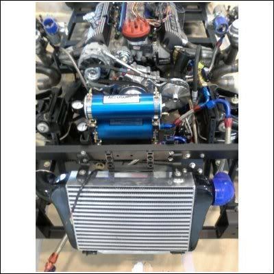

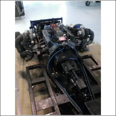

A few pictures of my project

Nice build up, I betcha that is going to haul some arse!!
