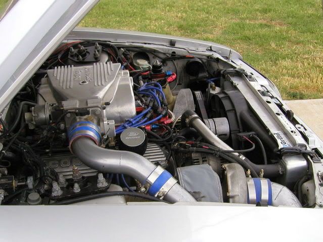

Not great, but here's a pic of curret set-up

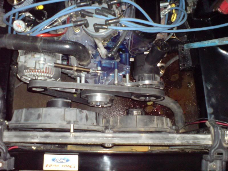

heres a few pics of my setup. Its a flex-a-lite 180 fan. I run it with a jegs fan kit and have had no problems with it yet. Stay cool.
Its mounted on a Be-cool rad, with custom brackets.

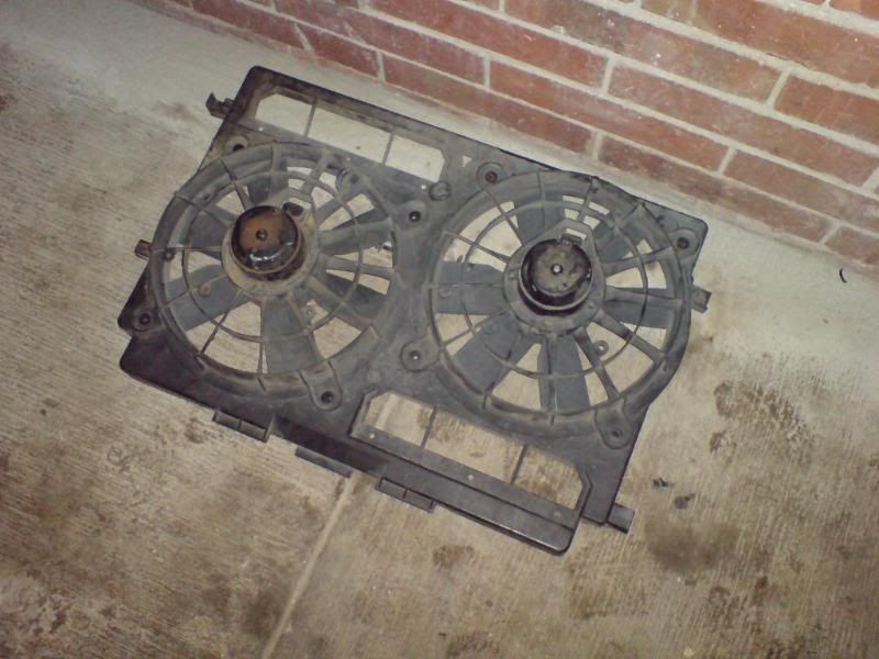

OK probly catch hell but I have a set of fans off a 99 LS juan camaro.

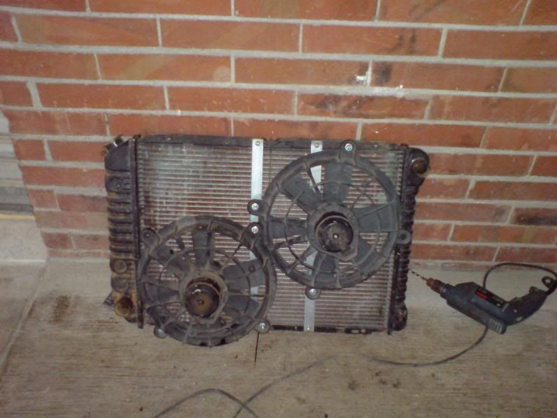

Posts: 842
my cooling system consist of two fans out of an lt1 96 camaro, i made some brackets, runs at 180-190, 200 in hot weather and traffic,
i want to change my stock rad in the future, because it is old and ugly.. lol

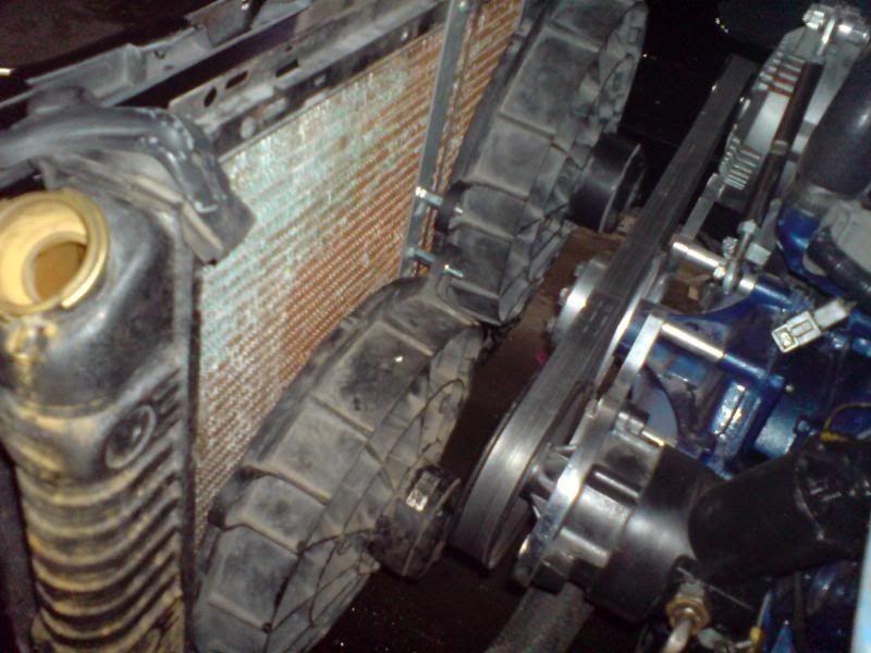

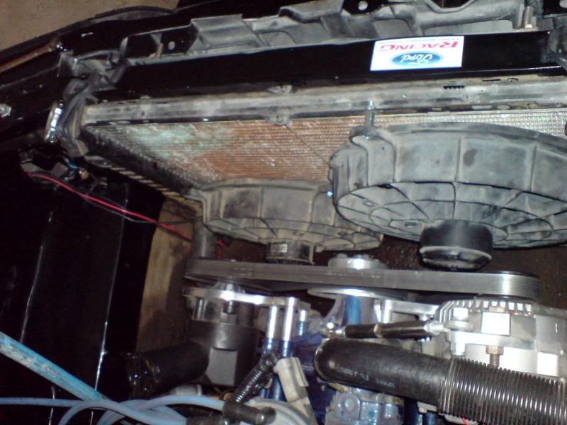

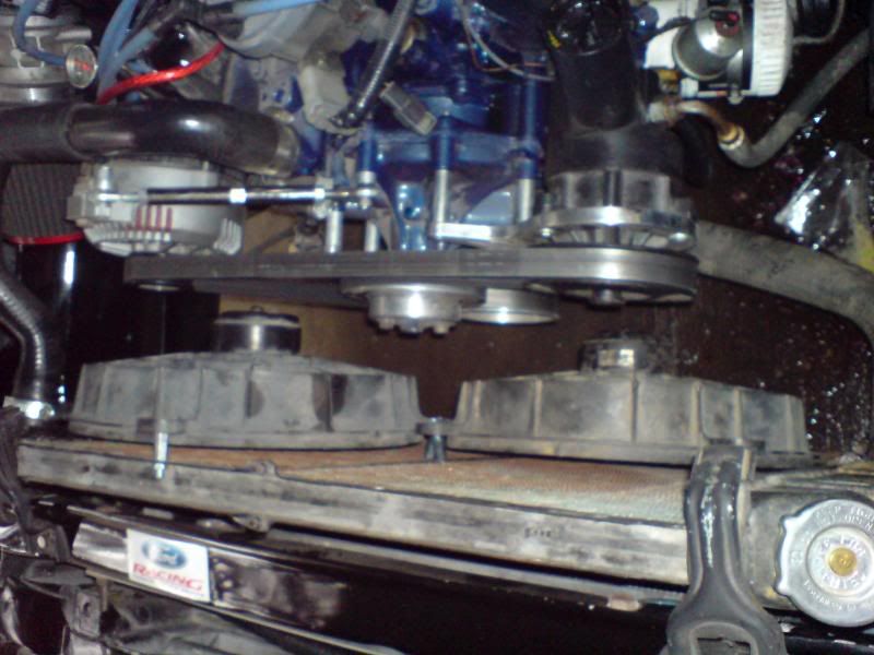

Be Cool rad and dual flex-a-lite fan. Had a summit high flow pump on the car but it turn out to be to much and I ended up taking it off for a stock one.
sorry for pic for some reason I can not make it bigger
