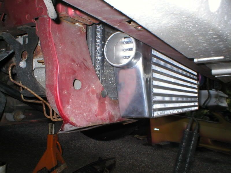

This is a 27x11x3. I didn't believe it, but you can fit a 3.5 in there. If I could do it again, I would get a longer and thicker one.
I still have all accessories.

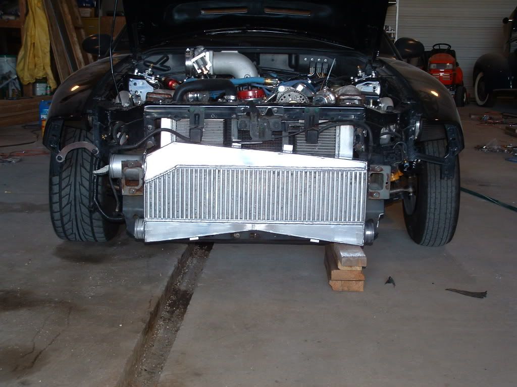

I do not have the A/C in but probally could have gotten it to fit. I spaced the top radiator supports back some for a little more clearance. This was a Bell core and mocked it up to fit then had a guy local to me weld it up.
