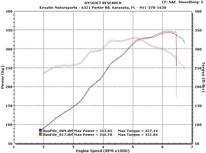

Sweet project! I was wondering, do you have a dyno sheet of the last NA setup? Also how much power to the wheels are you shooting for with this setup on the stock Mach shortblock?
Sure do. Pretty cool to be able to make 340+rwhp without removing the heads / using stock cams, with 281 cubes huh?
Like stated above, shooting for roughly 500 rwhp.

Posts: 4,432
T
Originally Posted by ModularSpeed View Post
Sure do. Pretty cool to be able to make 340+rwhp without removing the heads / using stock cams, with 281 cubes huh?.
Yeah man those are great numbers. I have the same heads and cams set aside for my next build. Wondering how come your HP peaks a lot higher than other people with he same heads and came? Do you have PSR or advanced intake cams?

Stock runner length.
It peaks where it should, and where most 99-05 n/a 4V's should.

with a masterpower 76mm
sonicblue96 is offline
post #22 of 166 Old 07-15-2011, 06:21 AM
Location: Dayton
Posts: 6,443
Originally Posted by metalman302 View Post
T
are you saying that it peaks higher in the RPM range or the peak power is higher than normal?
https://www.facebook.com/groups/481330828691064/
na svt is offline
post #23 of 166 Old 07-16-2011, 01:50 AM
metalman302's Avatar
Trader Feedback: (173)
Join Date: May 2001
Location: Phoenix, AZ
Posts: 4,432
For some reason I was thinking VolsFan and PC Pro peaked at a lower RPM but I went back and checked and I was mistaken.
