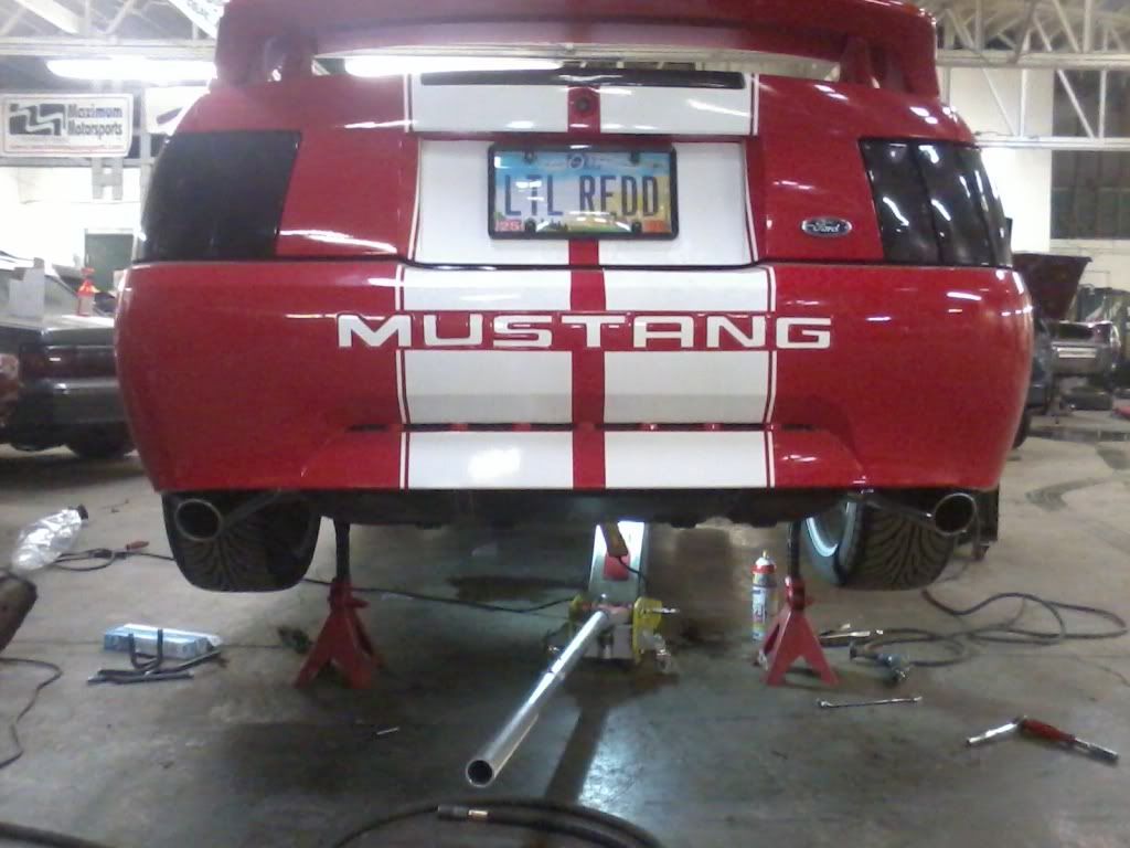

get a v 8 orh and a cat back, and have a exhaust shop mod it to fit!
i did the install on the following car
pics
the driver side, all bolted up no issues.
the passenger side front pipe got the most mods done, and all i really did was add the flangle from the stock 3.9, and sliced the pipe up and it all looks like a bolt on and is. the factory v 8 hangers from the passenger side rear would make things nice, but i just made some of my own up using stuff from the parts store.
