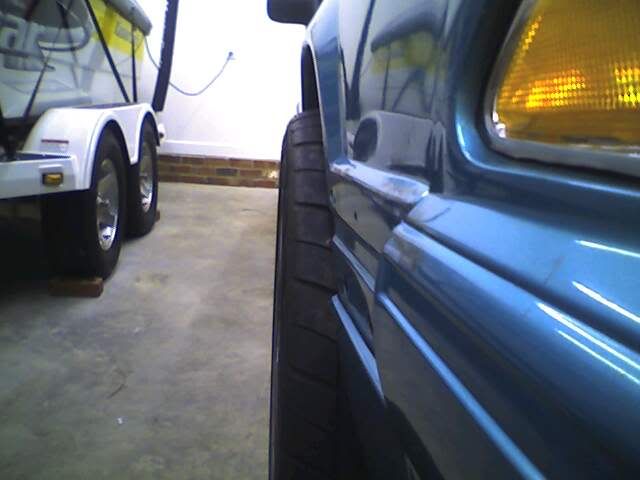

I am thinking that the spacers may send the wheel a tad bit beyond the fender wells. Mine were just level w/o spacers and had to adjust the camber. This pic was taken with the car in the air, so the wheels didn't exceed the fenders as much when on the ground.

I don't know what offset or backspacing the Ultra-Lites are (I'm assuming that these are Steeda wheels). Using the Baer modified stock spindles is not helping your situation though. An SN95 spindle/hub assembly would place the wheel about 0.25" farther outboard than the Baer spindle does. I would start by installing a 1/4" wheel spacer and see if that is enough to fix the problem. And as Fowler mentioned, loosen the strut bolts and retighten them with the top of the wheel pulled outwards.

post #12 of 16 Old 10-10-2005, 11:11 PM
