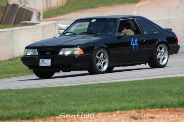

Fox dimensions vary widely, but here is an 89 (mine) with 96+ spindles and stock length Fox axles with North Cobra caliper brackets. The wheels are 17x9 R50's on all four corners and the tires are 245/45-17 Kuhmo MX's:
I'm running MM coilovers and CC plates, stock K and A-arms and as you can see, they fit under the wheelwells just fine. I do experience some rubbing on the plastic fender liner at high corner speeds.
Edit to add: I do have delrin bushings in the A-arms that offest them forward about .25" and Steeda X-2 balljoints. The offset bushings contribute to the rubbing as I get it on the front of the liner.

Thanks for the pics outafocus, looks good. I'm going to go that route also on the rear with the North Cobra caliper brackets.
