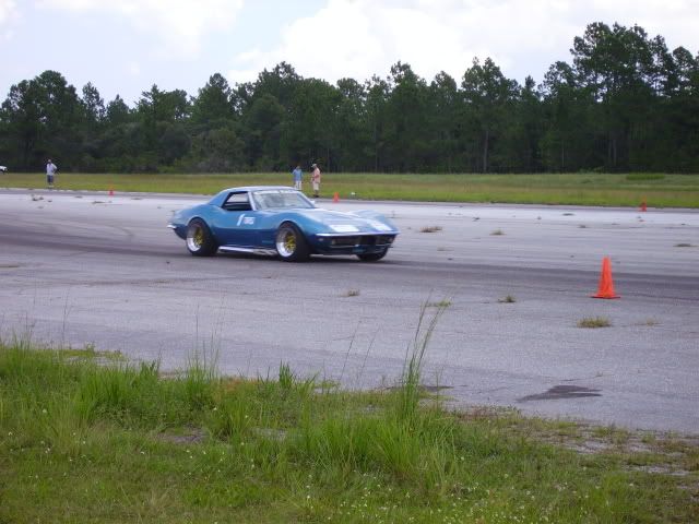

My best run was 42.88 which wasn't terrible. But the car had nasty oversteer. I picked up four cones the one run. I'll eventually go with some kumho victoracers, but I've done enough spending for now. I don't know if I'll run next month. The heat was brutal. I thought I was going to pass out with my helmet on. If I do run next time, I'm going to ditch the rear sway bar, and see how that goes.
I'm a ford man, but I love this car

The oversteer was from those non-compliant bushings in the rear. Removing the sway bar may help...a little. You really need to address the issue directly instead of putting a bandaid on it.
That picture is of "Fast" Phil Currin, the car is well sorted and fast. I managed to edge him out by .01 second back in May. He more or less smoked me in this month in my daily driver.
