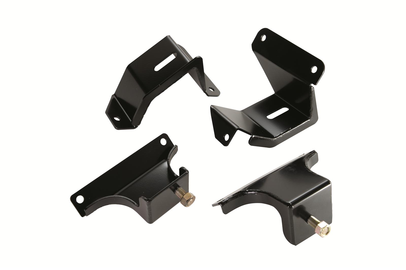

Those mounts are M-6038-CJPR. But if you want them, you'd have to go searching. They are NLA.
That said, it would not take a lot to make custom mounts.

The S197 engine bay is gigantic. The pushrod 302 is tiny. The 4.6 3V is like 26.5" wide or so. The pushrod 302 is about 18" wide.
Here's a picture of that frpp kit. Looks easy enough to recreate on your own. In fact I suspect you could fabricate mounts that line up with the stock k-member pretty easy.
