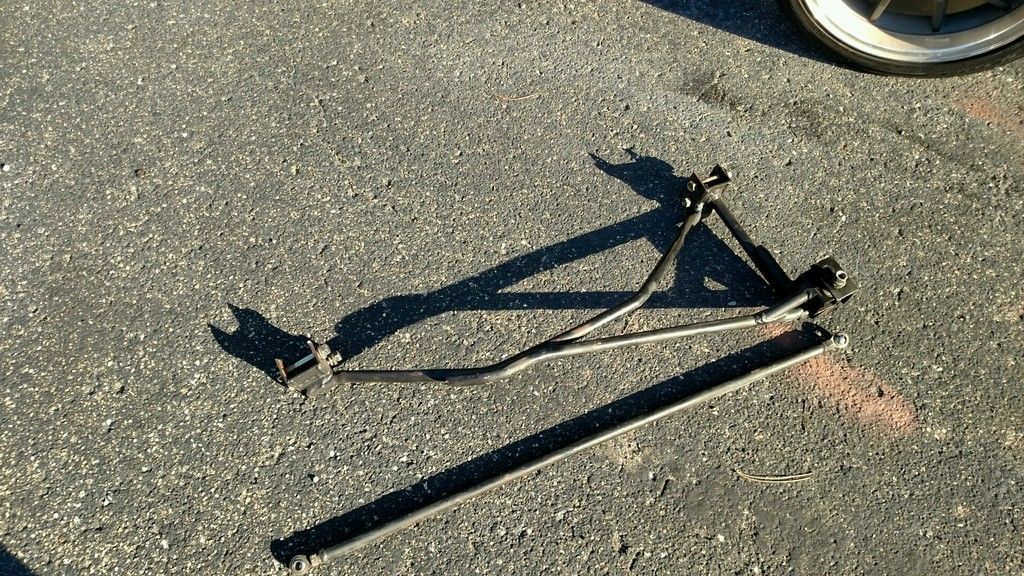

Best Panhard Bar for a Fox.
I think it's time to go pro and bail on my homemade piece. It was the best I could do at the time over a weekend with rented torces and a welder. It made a noticeable difference, but I want something more substantial now that I have it off.
I can only find the MMPHB for this car. Is that all there is?

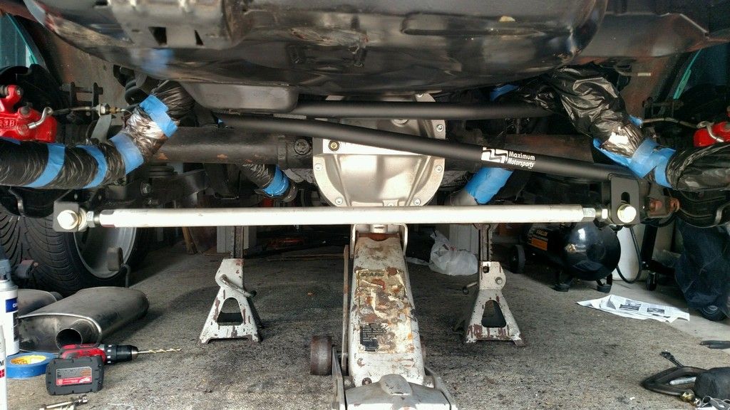

Just got it today from LMR. Looks like they're shipping it with the bare aluminum Bar.
[IMG]http://i258.photobucket.com/albums/hh269/leadfootdriver/4ea9a4c0-1e19-4bdb-b528-d9126890f472_zpsjdorkamu.jpg[IMG]
As far as I know, they always have.

post #29 of 33 Old 05-27-2017, 08:05 PM Thread Starter
midnightlaundry's Avatar
Join Date: May 2004
Location: Westland, MI.
Posts: 2,128
Got it in there after my Rear Gear and Subframes.. Kind of a pain, but not the hardest thing I ever did.
Now it's onto the Gas Tank and Fuel Lines. Then The motor..
