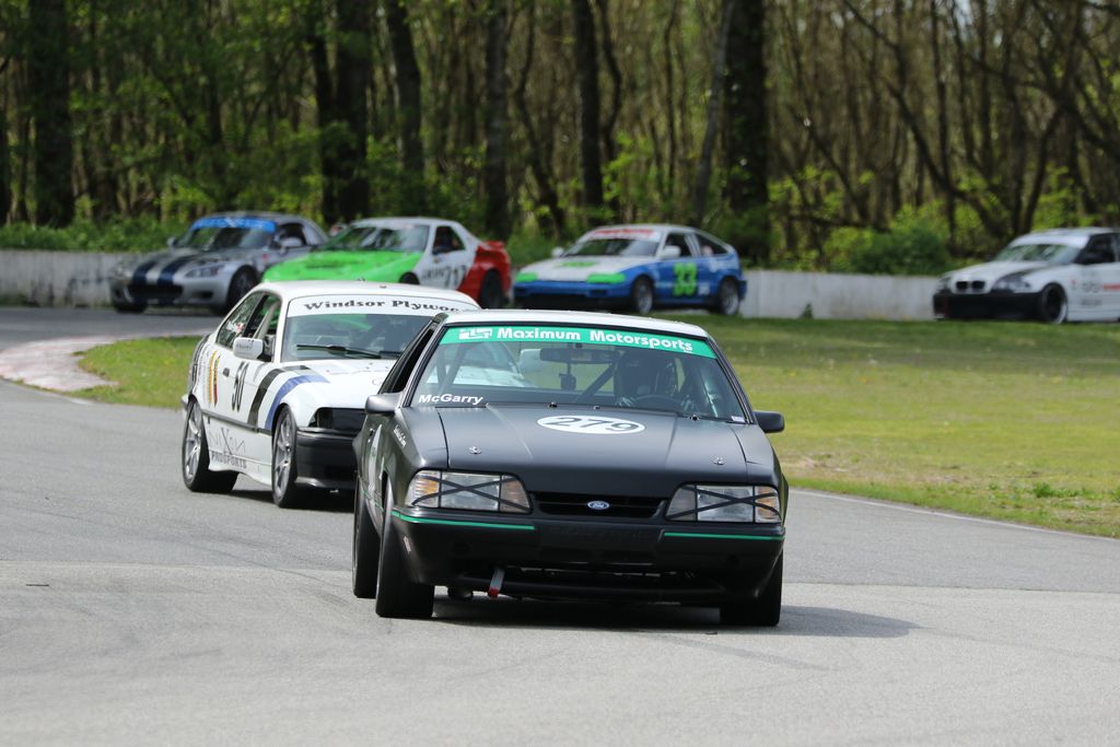

Bought an 88 Mustang for $500. Gutted and caged, etc......ran a few races end of 2015 to sort out and then the full 2016 season at Mission raceway in BC Canada.
Won the Championship and went quick enough to turn a lot of heads.
Lots of thanks to you all so I wanted to post a quick in car of a qualifying lap....went 1:18.7 in this one...ended up at high 17 by season end.

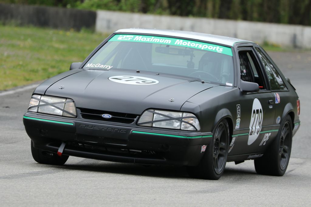

Tow strap is basically a heavy duty strap with a loop at one end.....welded mount point to the radiator well (sure there is a proper name) as far to the right as I could, then ran about 12 inches of 7/8 tubing from down near mounting point angled up to bottom of frame rail to prevent bending stuff if I ever (when) do need a tow.
Used super light tie strap to hold up some it does not hang down.
Let me know if you want a pic.

Originally Posted by Mike44 View Post
Ha !
Yes please

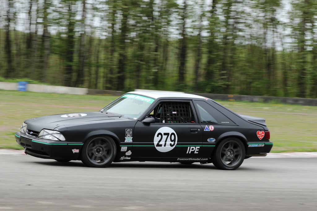

Thanks .... was a great project and super fun to drive.
IPE is Scca ITE ....sort of Open version of IP/IT classes
Bottom end is 100% stock...ported and matched GT40 set up for top end, Anderson N21 cam, 24lb, mass air convert, headers and no cats....big spark plug wires ( : stock computer
Stock T5 with good shifter
Cobra brakes Blue front / HPS in back
Susp in front is 1050 spring, cheap adjustable shocks, big bar...pretty precise bump steer set up.
Back is 450 springs, cheap adj shocks, driver upper cont arm on air bushings, MM Panhard and Adj sway bar
Nice and balanced, but bit slow mid corner transition. Brakes are finally balanced and stops ok.
This winter - going to torque arm rear, 500 springs in back, coil over front and tubular lowers, alum heads, fiber hood, and better exhaust........maybe maybe maybe a TK600 with .8 overdrive......maybe !
Should be worth second and a half....maybe 2 with the tranny.
