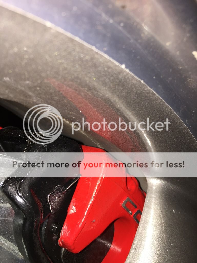

Well,
It's tight. But does clear. Need to get some pads for final test fit before confirming everything OK

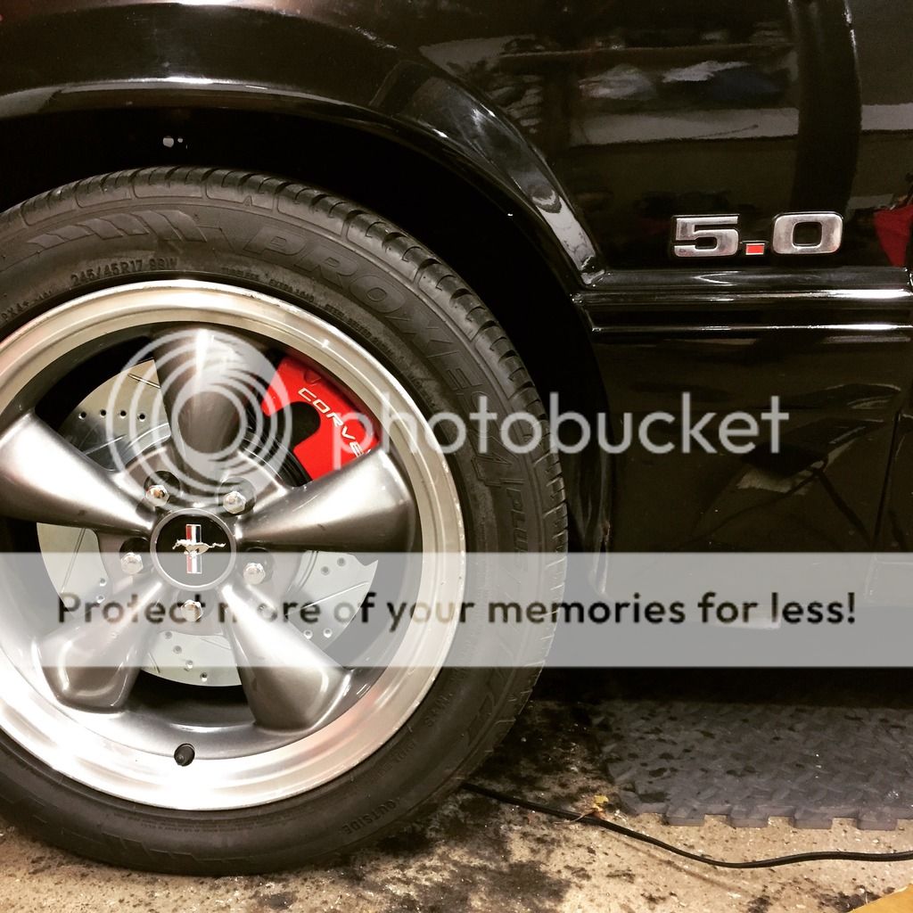

Just to update. Got this project done. Of course, snow now flying up here, so won't be able to head out to bed in the brakes and give them a try.
I'll eventually get my OE Ford cobra rotors resurfaced, but in the meantime trying out some "bling" rotors for my street cruising.
The rotors are 13" Cobra, the brackets are Baer p/n P/N CBK322325 which were $135 each, and the calipers are obviously GM, but a few other vehicles share the same casting. 05-06 GTO, and the caliper that comes in the Baer GT plus kit I mentioned before.
Fit is very OEM, and these share the same 40mm pistons my Mach 1 calipers had. I love how the pad sweeps more of the rotor face. One of my peeves of the cobra style brakes.

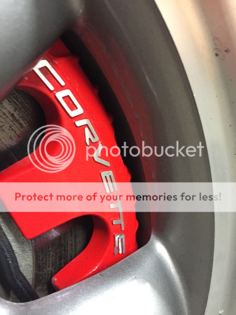

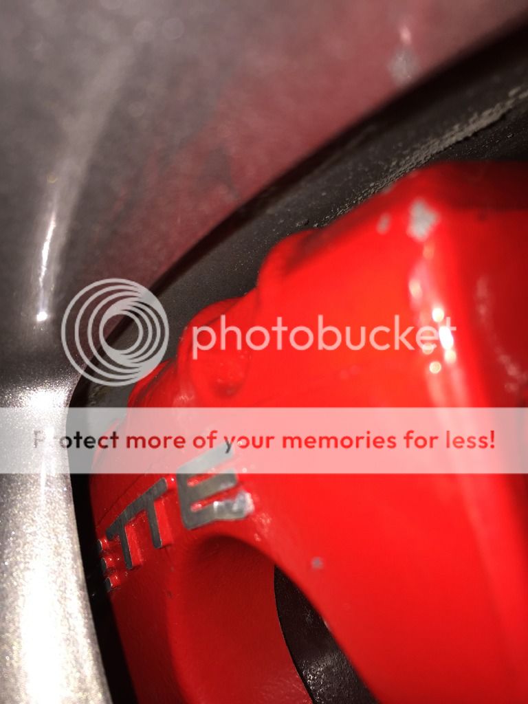

The caliper clears the rim with plenty of space, so not worried there. But tape weights would be close. I have some, so if i get a chance soon, i'll attach one and jack up the wheel and give it a spin.
The weights on my wheels are mounted on the outer rim, so not an issue for me, but i would like to run tape weights if i can.
Hard to get a sense of the gap from these pics however. (damage on caliper was preexisting. Why i only paid $50 for it brand new)

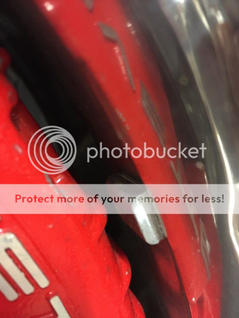

Putting a new set of rims on. These are for the street, so I want to run tape weights.
It's close. That's a 1/2" wide wheel weight, and the inside corner is maybe 2-3mm from the fin on the caliper? Caliper is pretty fixed, so not a lot of movement, and as it wears, the caliper will draw inwards away from the weight.
Need to decide. Should I run the 1/2" wide tape weights right to the outer edge of the inner rim portion as shown? I'd imagine there's not that much deflection. Again...this set of rims is for street driving only...to local coffee shop

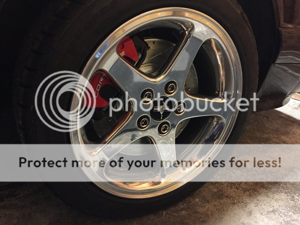

Ok, wrapped this up to the point where I think its done. Tire installed worked with me to put the weights in a good spot, and I think we got it done. Plenty of clearance. Just need to wait for the salt/sand to get washed off the roads and I can do some test runs and bed in the brakes. Also about to swap in an 03/04 Cobra rack as well.
One thing to note though was that between the Bullitt wheels and these 99/01 Cobra style wheels, the amount of room between caliper/rim did change slightly. I think with the bullitt wheels I'd have a slightly harder time getting tape-weights in.
What can't be done however, is the Cobra 17" spare tire. Doesn't fit over the calipers. The rim contacts the ribs on the topside. So it's a no-go with regards to that.

Here's how the car sits today. Wheel weight issue was resolved. No problem there. Car stops well, and combined with the 03-04 Cobra rack upgrade and solid steering shaft, it's VERY fun to drive these days.
BTW....17" Cobra spare tire does NOT clear these brakes.
